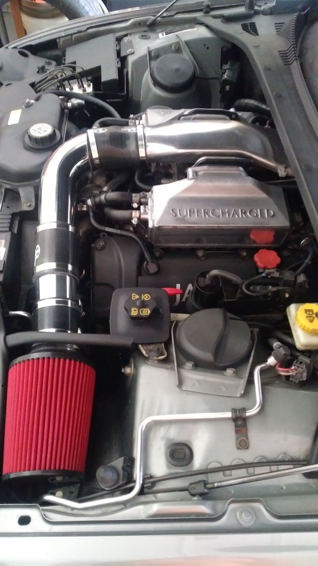

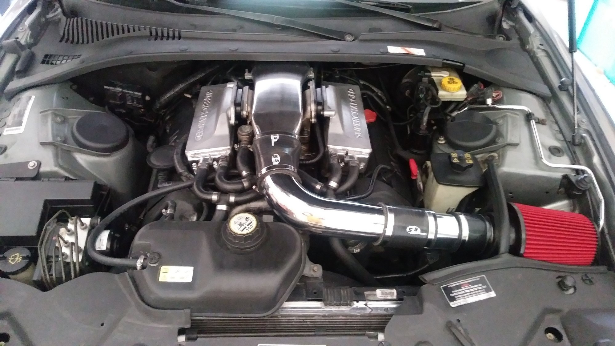

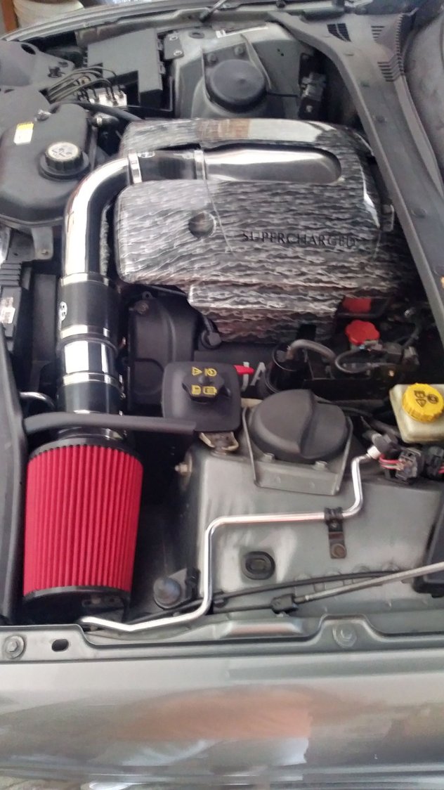

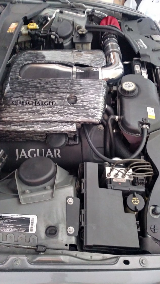

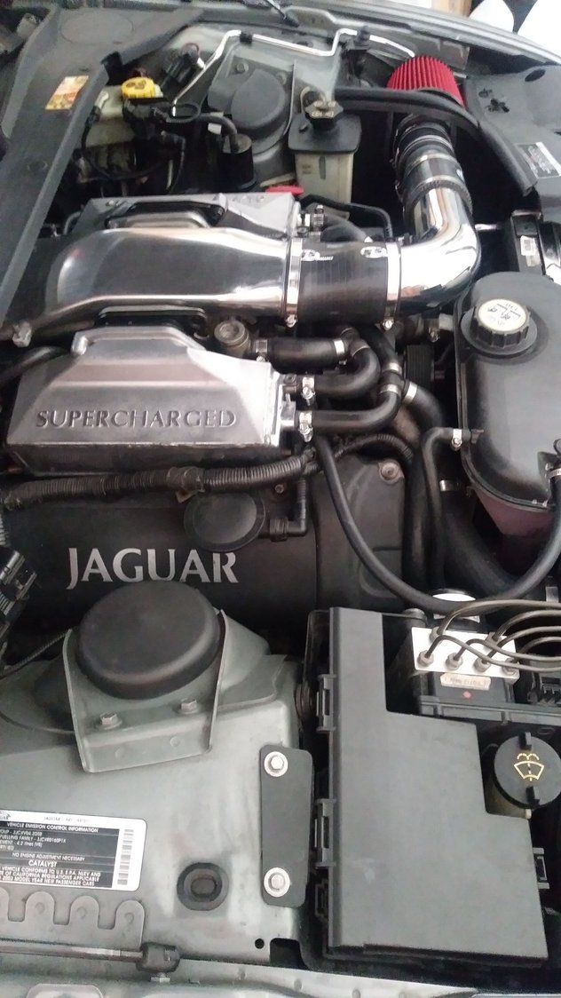

Yes, I have had the 1.9 boost pulley for two years, you will definitely notice the difference. One other thing to consider. Change out the tensioner pulley and belt too. I work through Jag Repairs in Pompano Beach, Florida, USA. He told me that they discovered the old belt will slip at over 2500 RPM. We did the pulley first and then a few months later the tensioner and belt, he was right, I got more performance once the belt was changed too. I am posting some pics of engine mods I did for ideas you may be interested in also. Intake was from Caldoofy here at the forums.

Just some pic of mods I did to the engine
