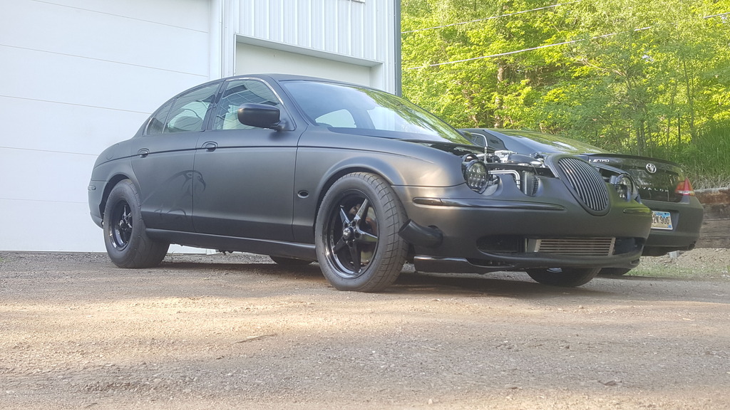

wicked !!!
i think a R mesh grill will help its look .
i thought you first said it was for daily , clearly its not , with no head lights , blacked out tail lights . and a flame thrower exhaust ,
or are your laws non existent ? or just loosely policed ?

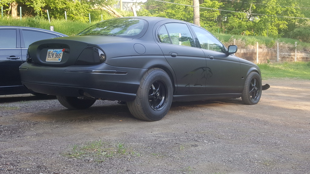

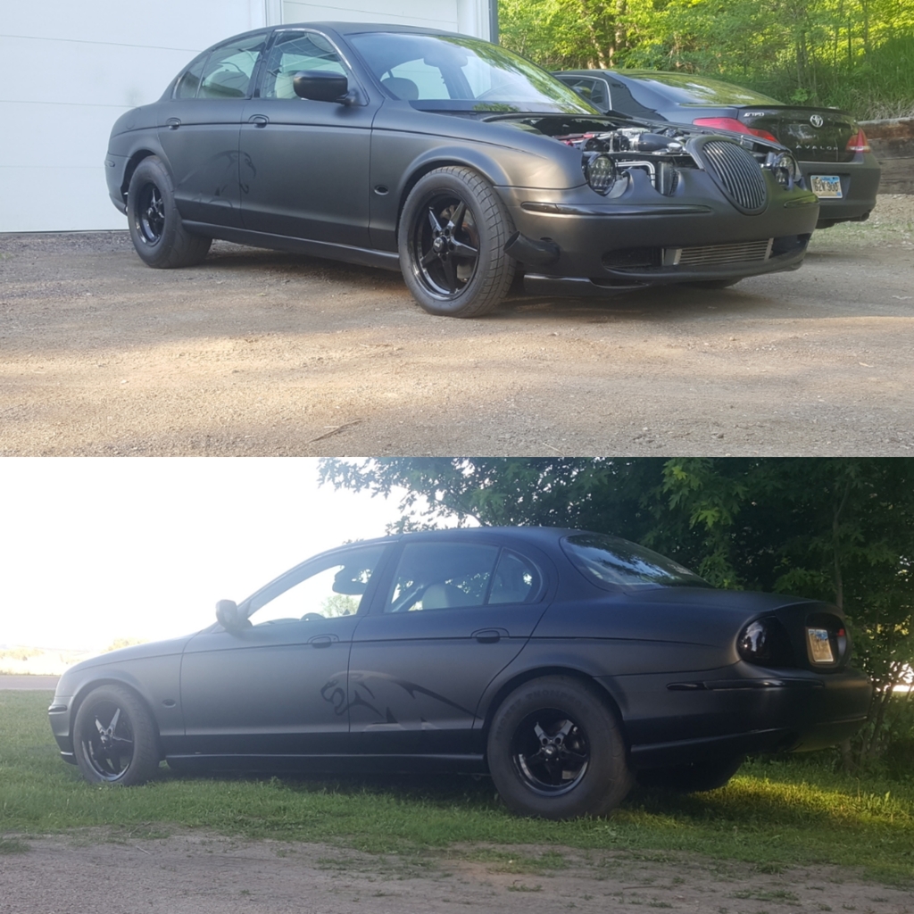

That looks insane! Well done.
How come you had transmission issues? Too much power I'm guessing?
I've got a slight feeling you're taking it to the strip judging by that tyre set up! Looking forward to more updates.

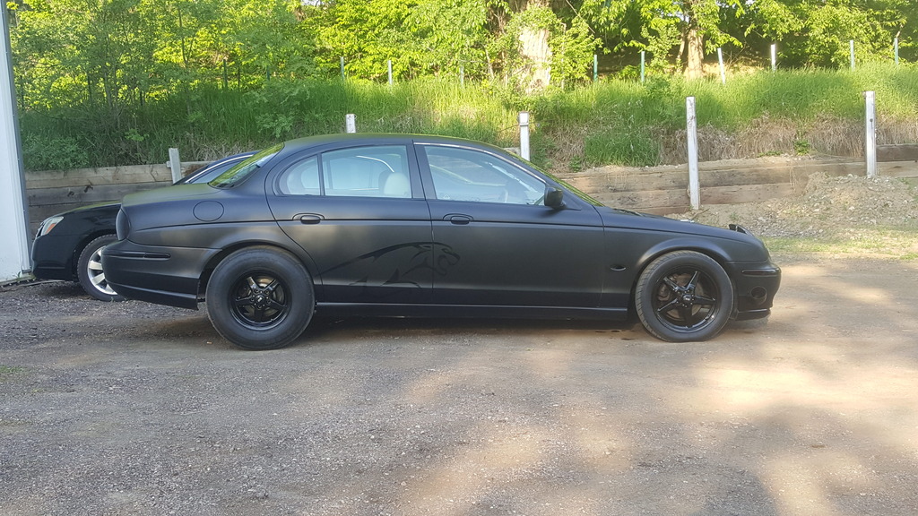

Fantastic work so far! I like the paint job. It looks like you converted the car to more of a 1/4 mile/strip car rather than a street car. I see that you tore out the IRS and put in a live axle. With the raised rear stance it will shift more weight forward, so cornering will suffer. Likely you don't have or need TCS, ABS, and dash functions.
You will have to post some drag times and HP dyno results someday.

Haha I will actually be DDing this car until the end of the summer. It does have head lights; however this is just my temporary setup until I finish building my actual ones, and they may be tough to see in the pics..Originally Posted by Datsports
wicked !!!i think a R mesh grill will help its look .
I'm in South Dakota, so I'm definitely not in a big city like most of you probably are. I also have an 87 Oldsmobile Cutlass that is just about a heinous as the Jag, and every time I've been stopped in that, the cops dig it and end up starting conversations about it with me. As long as you arent being an *** hat and putting yourself and others in danger, they are pretty tolerable. It's all about respect here.
Lastly, I recently picked up a R mesh grill for it, but I just haven't had the time to black it out yet. Hopefully I'll get it done this week.
Thanks for the compliments fellas. I really appreciate it after all the work I've put into the ol girl, and I love when people enjoy looking at it as much as I do.
As far as it being a daily driver and functionality of the systems. I truly intend to actually DD this thing. Right now, besides the factory gauges, the interior is fully functional.. GPS, power everything, memory seat/steering wheel, etc. I didnt bother with gauges since a touchscreen and mini computer that communicates with the ecu/tcu took their spot. Heat is functional right now, and I intend to put the AC back I it once I have it driving 100%. I removed the ABS, but I do still have traction control.. mostly for racing purposes however.. this is via my standalone ECU however. It is set up to pull boost/timing until the rear wheels are within the hysteresis with the front.
I'll hopefully be able to report back very soon with hp and track results!
