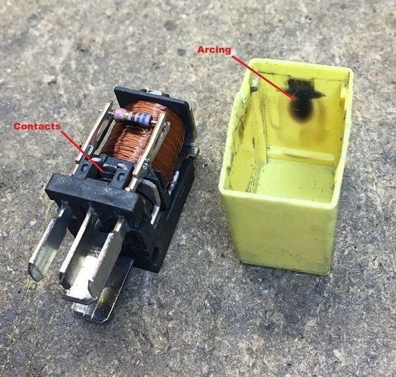

One possibility is arcing at the contacts of that Powertrain Control Relay 2, mischievously located at position R3.
If it passes the click test, that only proves it is receiving the command to energize. It does not confirm the internal contacts are making a good connection and sending full battery power to the coils and other components.
Here is an example of a failed relay:
This relay would have passed the click test. The contacts were arcing and restricting power output, though. But most likely a voltmeter would have shown a normal reading in an unloaded circuit. Only a minuscule amount of current is needed to drive the meter so you get a misleading indication all is good. However, there’s not enough getting through to properly power the whole circuit. That’s why I keep preaching to check circuits under load whenever possible.
Often, it can be tricky to take a voltage reading under load. Once all connectors are assembled, there’s not always access to backprobe the contacts. In this common situation with a suspect relay, what is the next best thing? Swap it with a known good relay from another circuit.
Another gotcha is potential heat damage from a bad relay. Inspect the relay prongs for discoloration due to overheated contacts. This in turn can overheat the sockets in the panel, affecting the spring temper and reducing the grip. A marginal connection leads to more heat and more damage. Replacing just the relay typically isn’t enough. Often times the panel sockets need love, too.
