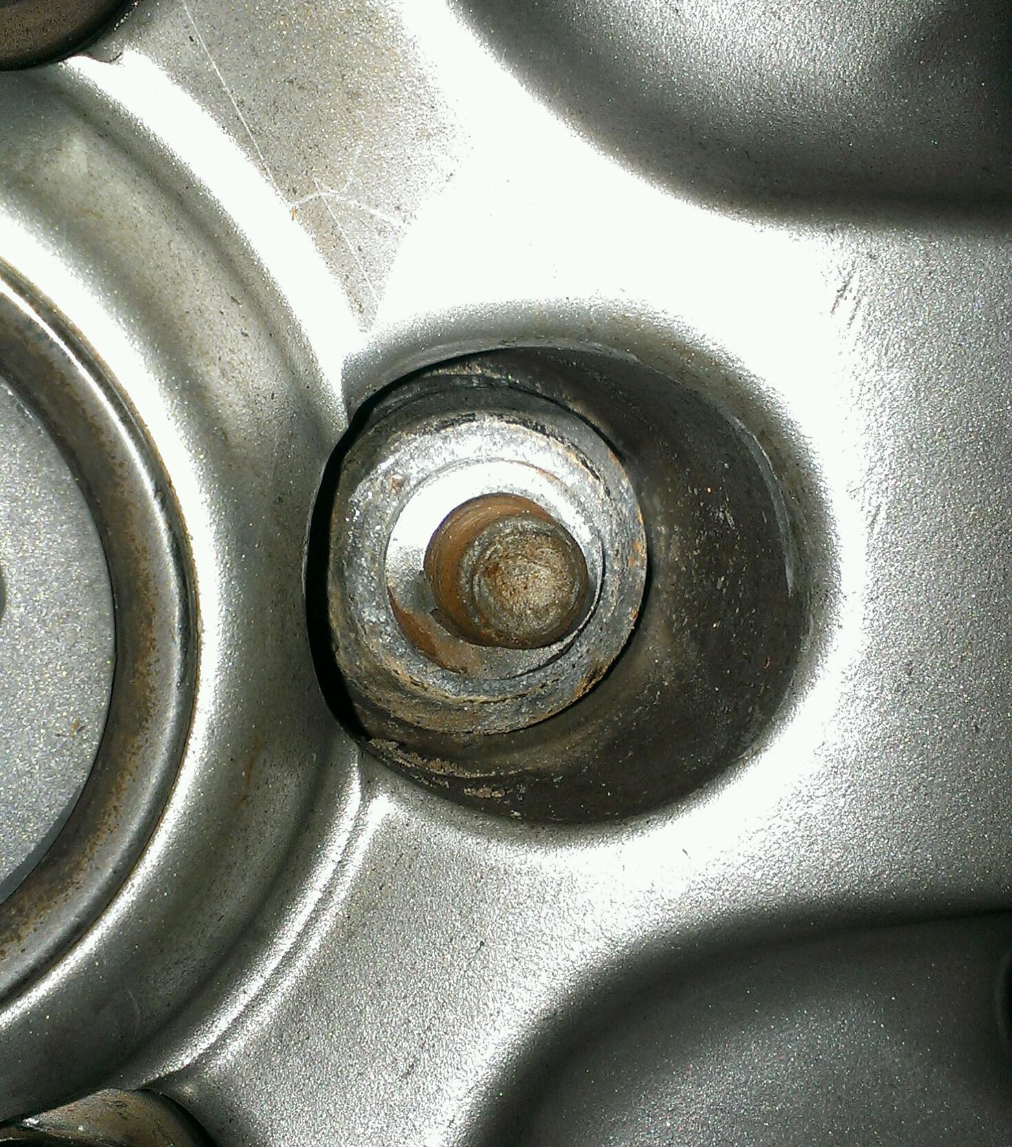

I broke off the top part of one of the lugs, was using the less then outstanding lug wrench that came with the Jag. the lower half of the lug is still on the stud and holding the tire. How do I get the reamining part of the Lug off ? I dont want to drill the Stud out, was hoping for an quick solve.
thanks

It's just a smaller nut, one of the sizes on a 4 way wherl brace fits it

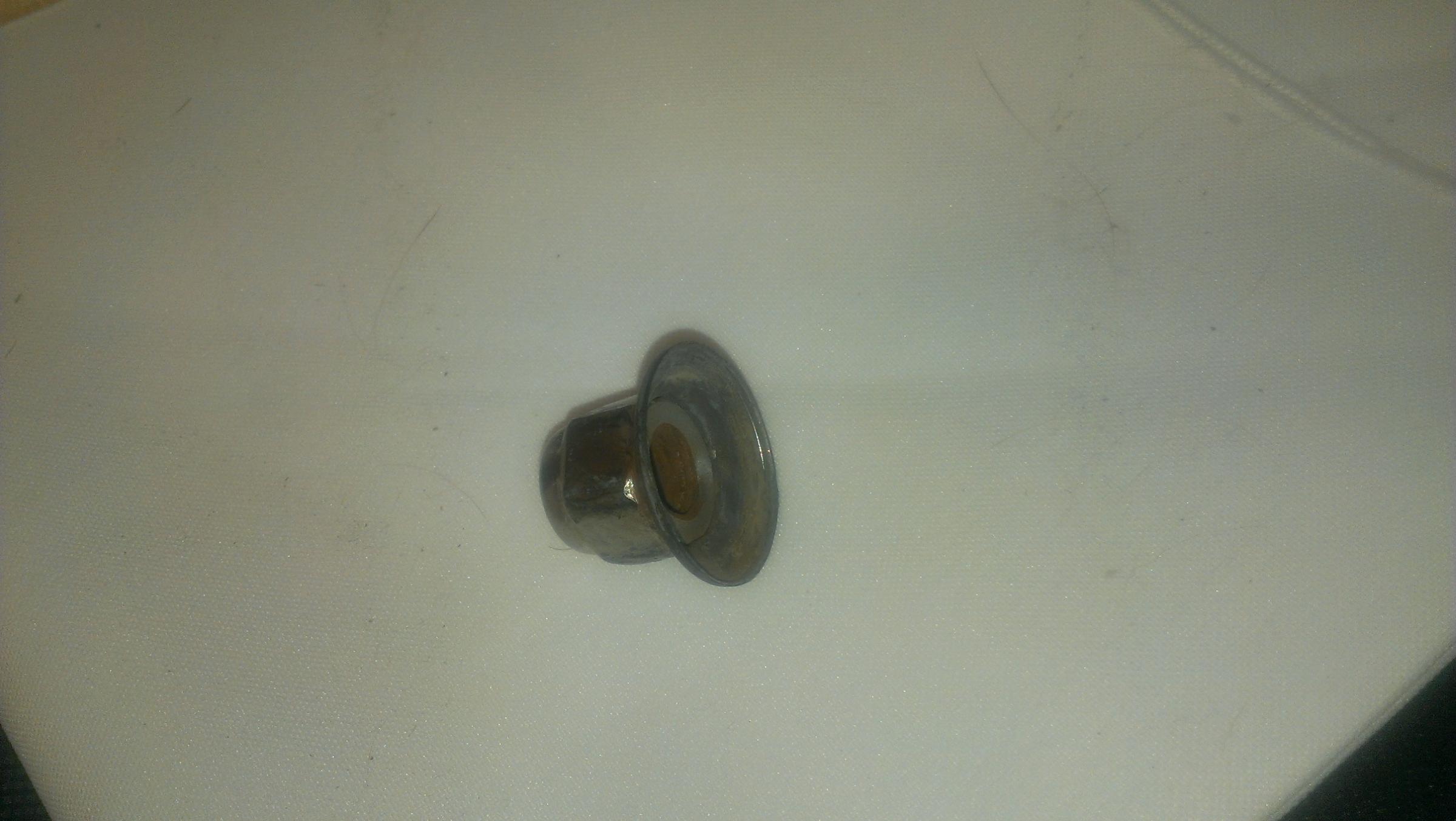

thanks for the reply, but see the close-up pic. there is nothing to put wrench on. its only washers

Is it completely round?

Wow, Ok, the outer nut cover coming off is very common but the is normally a smaller nut underneath, it happened to 2 of mine.
With it being totally round the only diy thing I can think of is either weld a bent rod of steel on the end of it or get an old socket, smaller than the shaft and hammer it on to remove it.

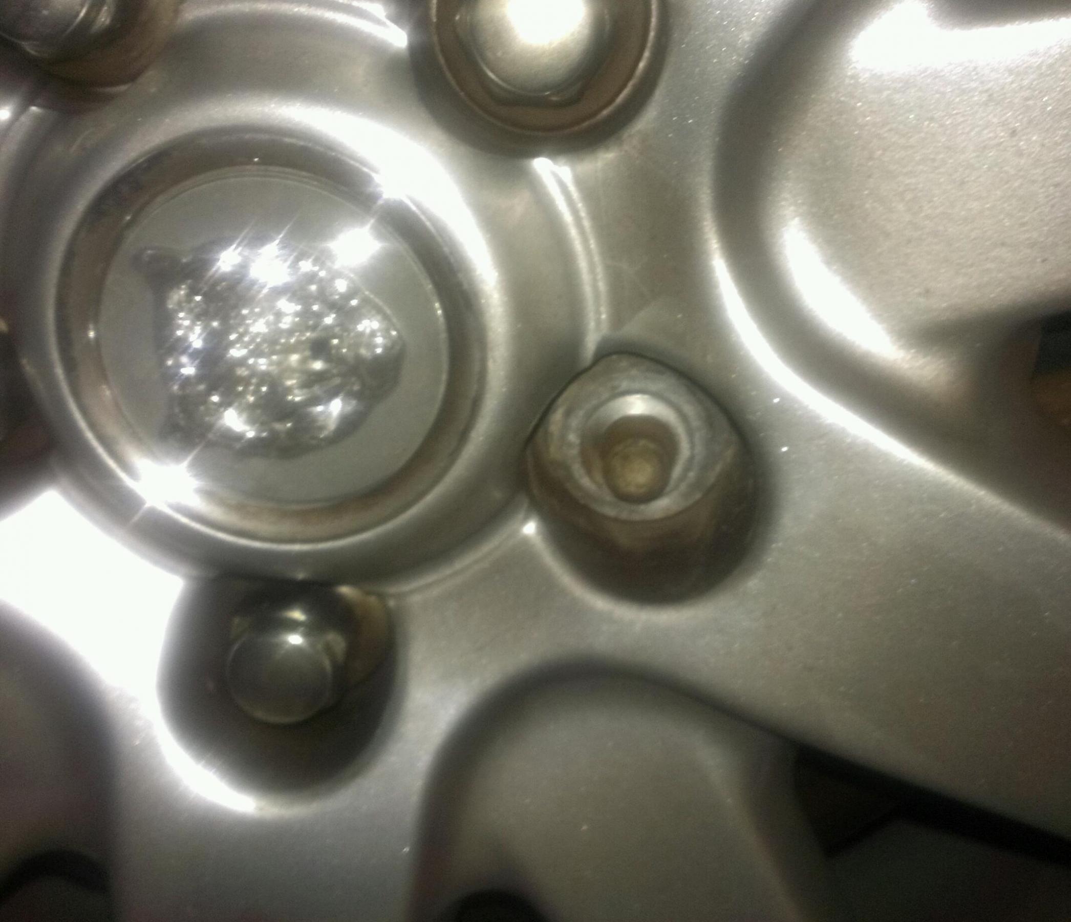

the Threads are still very much their. just the top of the nut broke off.

the part that is still on the stud, has never broke free, the head just broke fee first. its on good. been hitting it with penatrating spray so when i have a solution it might break fee a bit smoother.
if I weld a nut to the threads will I need to replace the stud?

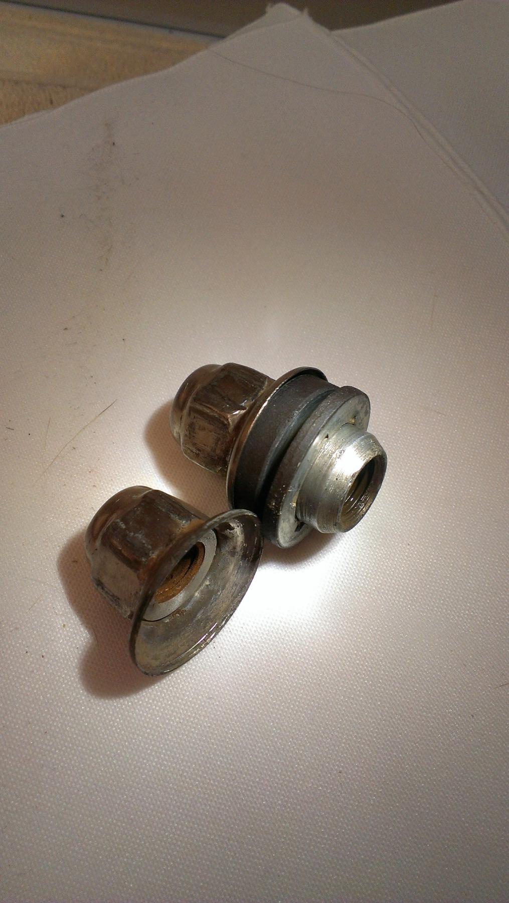

Originally Posted by kr98664
Looking as the shear pattern, can you determine if it broke on installation or removal? Look for ledges and steps created as it fractured, which help determine which direction is was turning when the fracture occurred. Also look for any signs of corrosion or weathering on the fracture surface. Clean = new (bad, broke on removal), versus dirty = old (good, broke on installation). That might provide a hint of how best to proceed.
The pic below indicates two things- very rusty threads meaning that no lubrication was applied prior to the installation of the nut. Bad, bad, bad.
It also shows signs of corrosion in at least three spots on the fracture surface. This means that the nut had been in this condition for an extended period and was in prime condition to shear upon attempted removal. As to what caused the initial cracks, I'm stumped as this surface should be in compression at all times.
