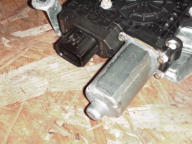

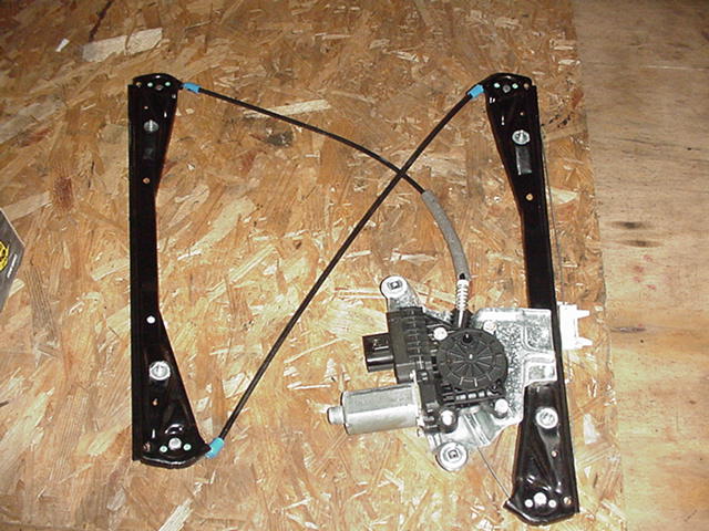

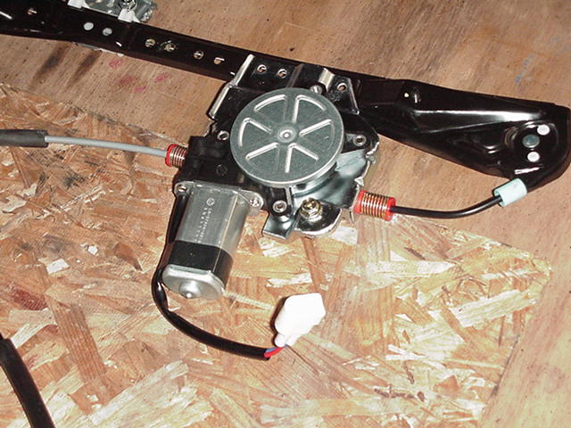

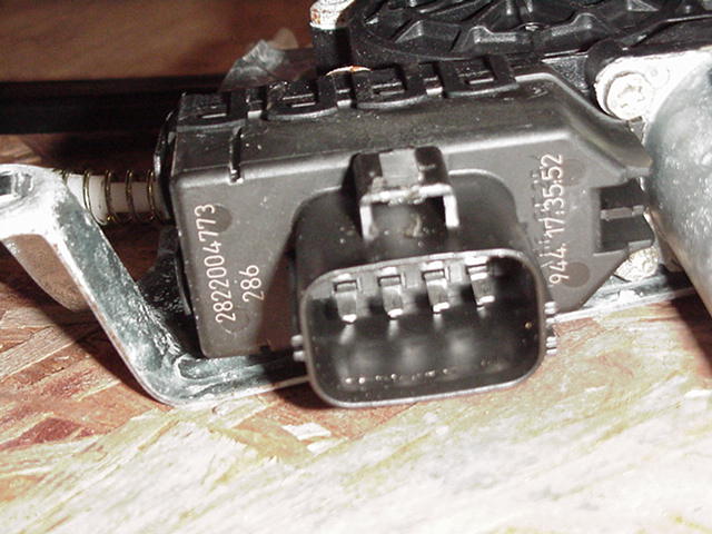

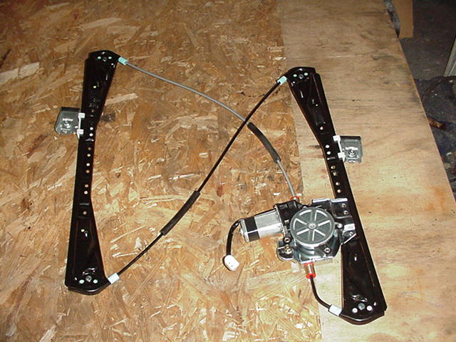

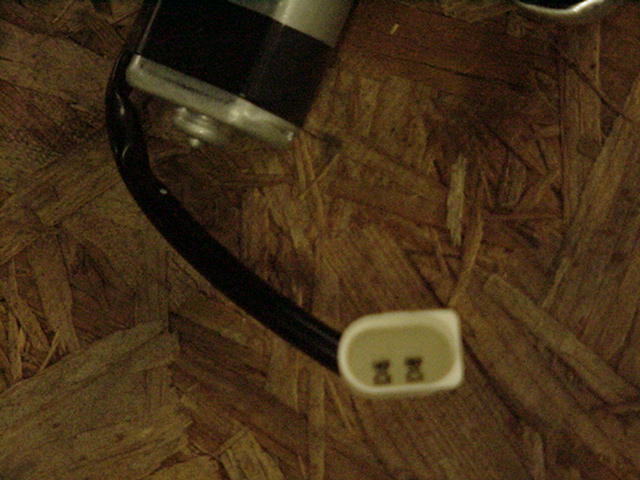

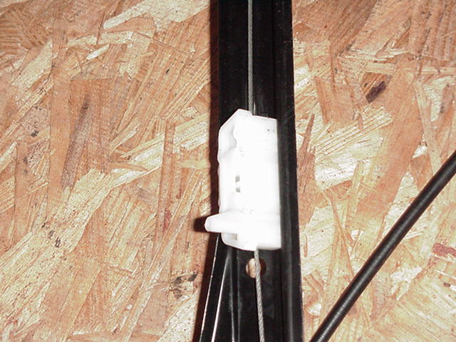

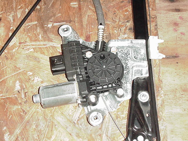

OK. Here are some pictures so future S-Type owners will know what we're talking about when comparing the Jaguar S-Type power window regulators and the Lincoln LS power window regulators. As you can see in the pics the regulators look the same but the motors are different. The regulator assembly for the Jag cost about $230 and the one for the Lincoln LS can be had on Amazon.com and other places for $68.00 including shipping!! Looks like Jaguar likes to make a healthy profit margian at the expense of it's owners. My local dealer quoted me $600.00 to do this job so this is why I came here to find out how to save some money!!
The first two pics show the Jag & Lincoln regulators. Very similar. The next two pics show the Jag motor then the Lincoln motor. Very different! The next two pics are close ups of the Jag motor then the Lincoln motor so you can see some detail. The next two pics are close ups of the plugs. They are not even close! The Jag plug has 4 pins and the Lincoln plug has only two. No way to make this work. So I guess you have to hope your Jaguar motor is still good or you can't use this Lincoln regulator at all. The last pic is the stupid brittle plastic piece of crap that is the cause of the whole problem. There are supposed to be two **** or pins on this plastic piece of crap but as you can see mine is broken. Once this happens the window will fall down into the door and you will hear all sorts of crunching noises as the cables come off their tracks and the carnage begins.
I hope this helps. I may post some more pics as I try to put this all back together. Somehow I see I'm supposed to "clock" the Jag motor on the Lincoln regulator so I can get my window all the way up and down. This should be fun. As you can tell I'm not real happy with my Jaguar right now.

So can you just switch over the motors or do you need to change the whole drive arangement.
It looks like the LS motor has the cables going directly to the motor and the Jag unit has the electrical connection integral with the drive casting.
