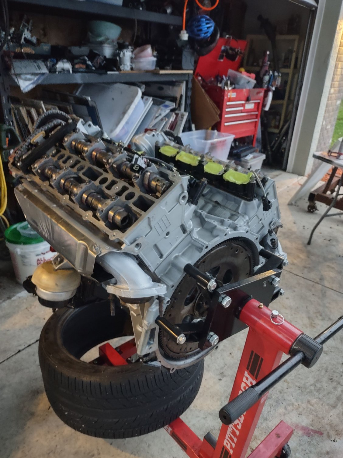

Getting closer to reinstalling into the car !

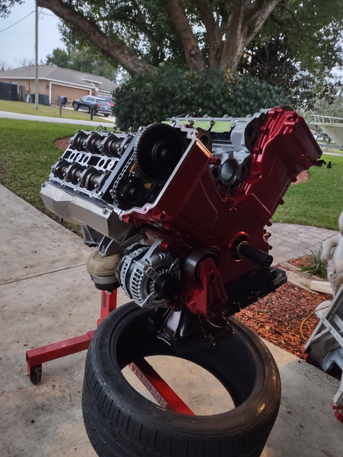

I Still need advise before I close up the front timing cover . I've locked the cams and crank with bars and key that insert into the crank. I tensioned the chains as per shop drawings . The motor turns free and smooth. I'm cautious because the timing obviously is the most important part of this build. So before I close up I'd like to be 100% certain I've done this step correctly . Unfortunately the dealer and shops in my area aren't any help with this . I've replaced every component and sensor on the car. Gaskets , etc. I've owned the car since new so I'm anxious to get it back on the road again ! Thanks

Excellent. Did you need to weigh each piston rod assembly. You bacically rebuilt a race car engine. Great job. Sorry cannot help with timing question. Just a thought. I would think that when you set the tappet clearance a timing issue would show up during that procedure

When we disassembled the engine the machine shop said there was little to zero wear on bearings or any moving parts . I took the motor out because the car started blowing smoke really bad. The heads were rebuilt and we replaced the piston rings and put everything back together . I drove the car 235 k miles before I had to do this. I felt it was the best way to preserve the car in its original condition. The valve seals were bad and the piston rings were frozen with carbon . It's been challenging to find parts . Some parts are interchangable with some Ford stuff . Like exhaust manifold studs and some other . We replaced head bolts and push rod bolts and crank bolts . I swear by Lucas pure synthetic and after taking apart the motor I believe adding a quart w every oil change will prolong the life of your engine. I also own a xf portfolio that's closing in. On 200k miles . The 03 has never broke down or overheated . Thanks for asking .

In case you haven't seen this already, here is a link to the engine course that explains how to set the cam timing:
https://www.dropbox.com/s/vqpy3bbjzd...e_168.pdf?dl=0
Pay particular attention to page 26 of the course (page 74 of the PDF) regarding setting the correct valve timing of 45 degrees ATDC.

Thank you for the repir manual you sent . I followed the procedure as described . I have the tools to lock cams and crank . I'm gonna recheck it one more time and do a final torque of bolts and release the tensioners. The engine is almost ready to go back into the car. I'm waiting on o rings that go on the front cover to close it up. Jaguar Land Rover classics in California were a big help getting parts and gaskets. I'll post an update as soon as I have one . Thank you again
