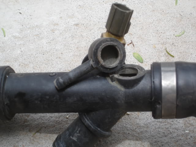

This hose doesn't come with the metal part that I think holds the thermostat housing but I don't need that part anyhow. Mine broke the round plastic thing off the top of the plastic center tube next to the temperature sending unit. There's no way to fix that (of course).

I got mine from Nalley but that looks like the thing less the thermostat and housing.
Here's the pic from Rockauto.
and here's the plastic bit from mine.

That thing that looks like a tank turret is what broke off on mine. What a lousy dessign in my opinion.
Snap! Me too.

Recieved mine few days ago from rockauto, was installed in service. Today turret fall apart on my way home. All coolant drained. Hope warranty covers it and I will get replacement and I didnt get problems with engine.

The plastic part you refer too is not available by itself if you are talking about the "turret" looking plastic piece that a small hose attaches to. You'll have to buy tyhe whole upper radiator hose to get it.

Suggesting you buy only original, I faced a lot of troubles with aftermarket upper radiator hose. I changed two of them and twice got stock in the middle of the way with pomped out turret. At the end I ordered original OEM part and so far everything is perfect.
I sent almost 1K on mechaniks and towing car, due to this aftermarket hoses. Brand name was "URO Part".

Hmmmmmm. The upper radiator hose shown on www.rockauto.com today is NOT the one I ordered last year. This one looks totally diffferent and is less than $35.00. I paid $59.00 for the one I got and it looked just like the original on my car. The hose they sell now doesn't look like it has the "turret" any longer. I'm not sure I would order this hose. It doesn't look right.

Originally Posted by Norri
Snap! Me too.
Can't you just stick it back together with a product like Plastic Weld or similar??

So it looks like the tip of that turret looking thing broke off on my car,. I don't know when it happened, so i don't know who to blame! Hahahaha. I too cannot find that upper hose. I checked with RockAuto and they said without a part number, they couldn't search for it.
The mechanic tried putting a brass fitting to replace the expansion tank connection (nipple of turret) with no success.
Does anyone know the part number of this upper hose? I don't need the hoses and such, but if they come with unit, so be it. The only issue I have is the cost some places want for this. Outrageous!
