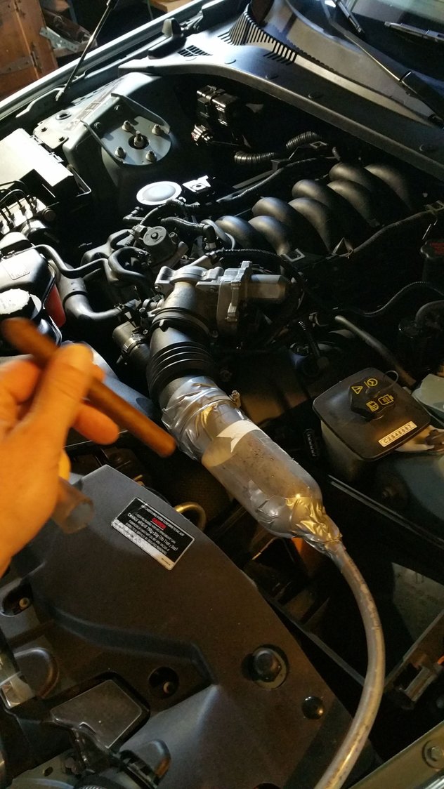

Vacuum leaks can cause restricted performance. The ELM 27 will show you fuel trims, and you can do various tests at idle, at load to see of it points toward vacuum leak. (See smoke tust idea below to id vacuum leaks). Leak at downpipe exhaust flange right before O2 sensor can also cause lean condition and restricted performance. That was my problem. Took a while to figure out. And you can do simple propane in air intake and see if fuel trims drop (if ELM 27 won't read oxygen sensors directly) to test oxygen sensors.
Fuel trims are key to many diagnoses. Get ELM27 and watch this and you can become a pretty decent amateur mechanic.
https://youtu.be/5WnM_NsOtd8
Cigar smoke test.
See nit wit Scotty Kilmer's youtube on cigar smoke machine. It actually works.
