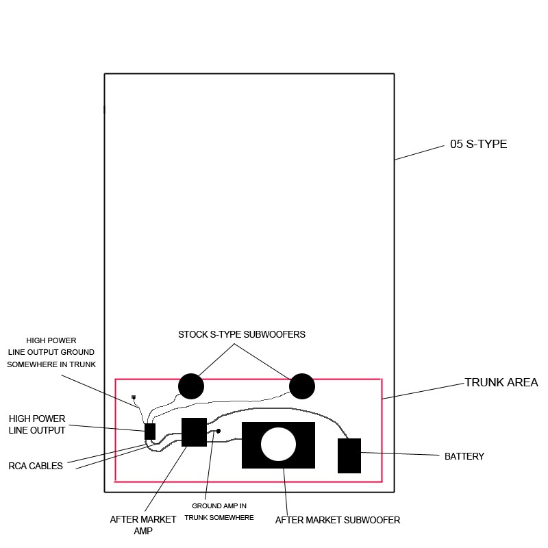

Hey everyone the time has come where I want to continue with this small project I did some small research on how the installation would go and I think I pretty much got it...or at least I hope so . I did a poor drawing outline...Someone please tell me if I'm correct on my drawing outline !
For hardware I'm going to purchase:

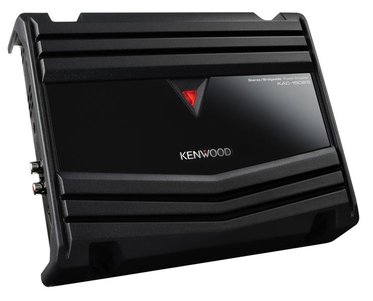

Kenwood KFC-W3013PS 12" Subwoofer
Kenwood KAC-1502S 350Watt Stereo Amplifier
(does it matter if I get a mono or stereo amp?)

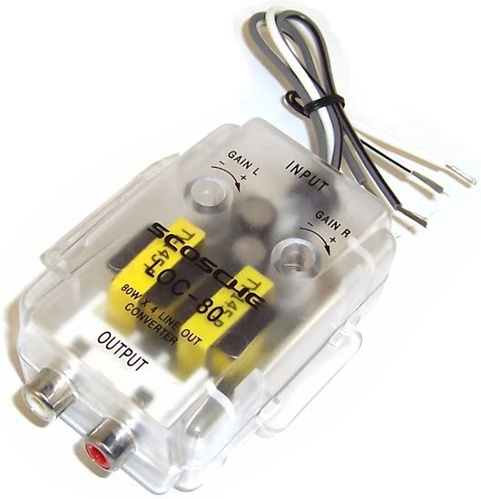

Scosche LOC80 2 Channel Line Output
Single 12" Subwoofer Enclosure Box
And wires
What do ya'll think ? I'm not going super high end I just want some thing better than the stock subwoofers
Attached Thumbnails 2005 S-Type Subwoofers ?-0njv.jpg   2005 S-Type Subwoofers ?-ugea.jpg   2005 S-Type Subwoofers ?-fwsx.jpg   2005 S-Type Subwoofers ?-2pza.jpg
And wires
Hey,
I don't have the tools available to edit your diagram but there is one important thing to note here.
First, you need to cut the wires going to the factory subs and wire them to the line output converter. Don't just tap off of them. Trust me you will NOT miss them. Ideally you want to remove the factory subs from the rear deck to allow the bass from the new sub to penetrate the cabin better.

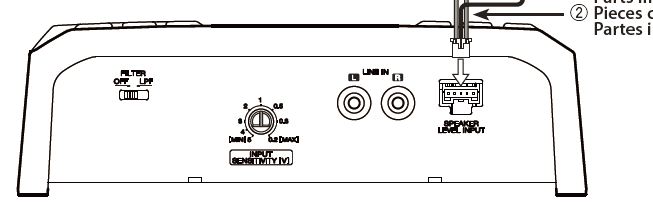

Second how many channels the amp has doesn't matter, but be careful with class D subwoofer amps. Make SURE you can turn the crossover off. The signal going to the factory subs is already filtered, and if you can't turn off the electronic crossover in the amp, you will filter it again, making the amp pretty much useless. In your case I took the liberty of googleing the amp you mention and you are good. You can turn the filter off.
Here is the link to the amp owners / install manual.
http://manual.kenwood.com/en_content...ad/1000009188/
Make sure you keep the amp like this - filter switch set to off:
Third, you need a remote turn on wire to turn the amp on and off. There is no such wire in the factory amp harness. HOWEVER there is an accessory power plug in the trunk that jaguar hid. It's behind the driver's side electronics rack above the battery. It's a plug with 3 female spade connectors. It should be clipped to the top bracket on the rack. I believe that the bottom right connector is ignition switched +12v but it's been a while so don't quote me on that. Use a multimeter and find out for yourself. There will also be a ground and a constant +12v in the harness. A simple male spade crimp connector will plug into this harness.
Here is a pic of the connector with the remote turn on attached:
Now onto grounding. There is a bolt on the passenger side beneath the tail light area that is a factory ground point that will work perfectly.
Here is a pic of the bolt with my 4awg ground wire attached:
I hope this helps. If you have additional questions feel free to ask.

Just a quick addition, that amp can take speaker level inputs ie has its own line converter built in so you would not need the external converter or an rca cable.
The factory filtration point for the standard 'subs' is too high so I would still use low pass filter set to approx 80 Hz to clean up the sound, definitely remove the standard subs and have your new one orientated so it faces out of the boot as opposed to up like the standard ones as this will improve the sound no end .
Lastly set up with the dsp on front, this boosts the signal to the sub and means you can quickly and effectively reduce its output by simply switching to 'All'.
I am running a focal 12 inch sub with focal monoblock amp and it sounds infinitely better than stock ! Enjoy.

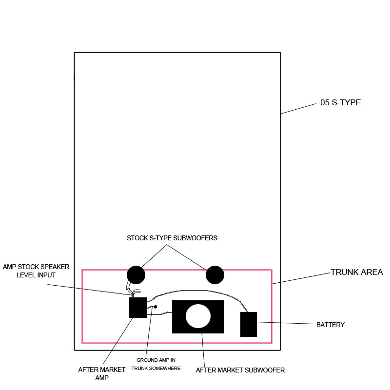

So I wouldn't need that Line Output Converter? The amp has one built in you say =o ? I re-edited my outline drawing to what you said in your post, hope it's correct =D I already purchased the converter last night including RCA cables which came out to $27 =( Going to try to cancel my order & save myself $27 !
Wait!
Well ok your amp has speaker level inputs, but are they designed to handle an already amplified output? Don't forget this isn't a radio output but you are taking the output from the existing amp. I blew the input stage on a sony amp a while back trying to do this exact thing in an old BMW 740i I had. Reisistor got so hot it unsoldered itself from the board.
That's why I recommended the high power line output converter. Could you maybe get away with it? Sure.... But I wouldn't try. The line output converter is guaranteed to work, and wont cause any issues.
Just my .02 of a dollar.
Take care,
George

Originally Posted by androulakis
Wait!
Take care,
George
Probably not ! I'll just use the external line converter. Just in case ! I have no knowledge in car audio so I'm agreeing with what everyone else says as you can see LOL !

The newer, "high power" loc's have larger resistors / capacitors in the input stage than the older ones did. They are designed to handle 80w rms inputs. I have a couple made by scosche here at the moment.
If I recall correctly the jag alpine amp allocates 40w to each sub. A decent aftermarket head unit makes about half of that. I'm not saying it won't work your way. But I don't know if the $69 kenwood amp being discussed in this thread will be up to the task.
