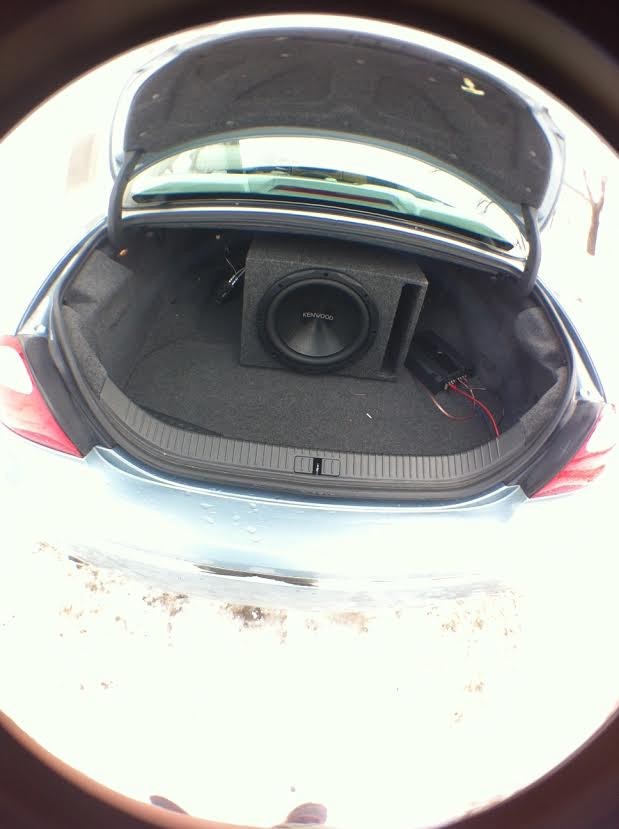

Hello Everyone, Mission Accomplished ! I finished installing the after market sub & amp this past Friday !...I'm very impressed on how well it sounds. Installation wasn't as bad as I was thinking it was going to be, it did how ever take me several hours (4-5) to complete..reason being I don't have a garage and it was cold outside so I went in and warmed up about every 10 or so minutes LOL..also took me some time to figure out how to remove the stock "subwoofers"...but after some searches on our good ole jaguarforums I luckily found some posts on how to remove them !
Here are some photos of what it looks like now...I didn't bother doing cable management or screwing the amp to the enclosure as it was COLD, will probably be doing that today as it's warmer out.
