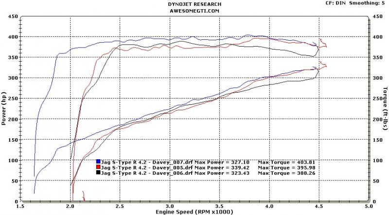

There are already dyno sheets, as I mentioned before.
Such as www.jaguarforums.com/forum/attachments/s-type-s-type-r-supercharged-v8-15/1333d1254939586-gabriel-s-type-r-build-thread-stock-dyno-pdf
you might like this thread too
www.jaguarforums.com/forum/s-type-s-type-r-supercharged-v8-15/2005-s-type-r-track-times-54121/page7/
can't recall where I got this:
