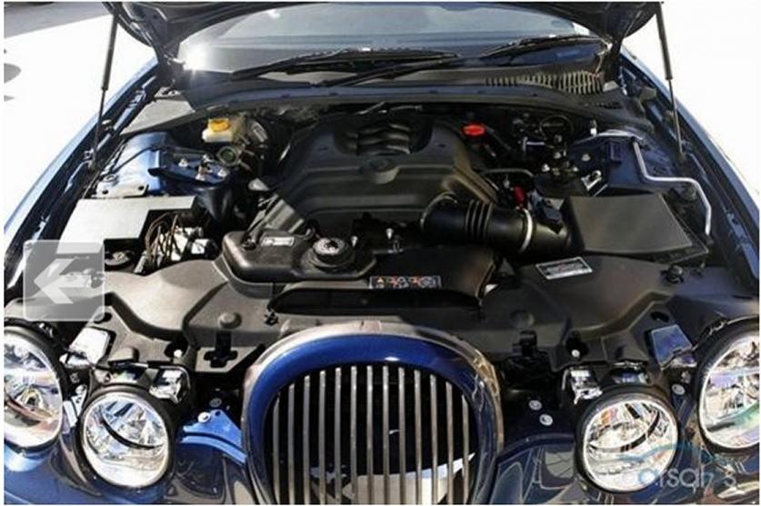

Can anyone tell me if this S-type is a 4.0 litre or 4.2 litre by looking at the motor? I think it is a 4.2 litre version as the 4.0 litre version has a different inlet manifold setup.
Can someone verify this? The car is in a dealer yard but not a Jaguar certified one and the sales person does not know anything about the S-type.

What year is it? 4.0 from 00 to 02. 4.2 from 03 up.

Engine looks like a 4.2
2002 year.
The layout with the extra cowling looks like a 4.2litre.
I just need to get people expert advice.

The pic above sure looks like my 2003.
Here's a 2002:

is there any markings or vin number that will give me 100% assurance that it is a 4.2litre?

I don't have a VIN reference available. A quick call to a Jaguar dealer with the VIN in hand will tell you what the car came with. Now, if the previous owner changed the motor.......

Look at last 6 of VIN. 4.2 started at VIN M45255
(i.e. 2002.5MY).

If I'm correct with my facts, the 4.2L engine first came out in the 2003 model year along with the revamped dash and parking brake arrangement and the 6 speed gearbox. The trunk lid should also say V8 instead of 4.0
Does the car you're looking at have all the newer features?

Here is a picture of the interior. It has the newer electronic handbrake setup in the centre console. Its being sold as a 2002. This is where my confusion is.

Definitely not a 2002 or earlier.
