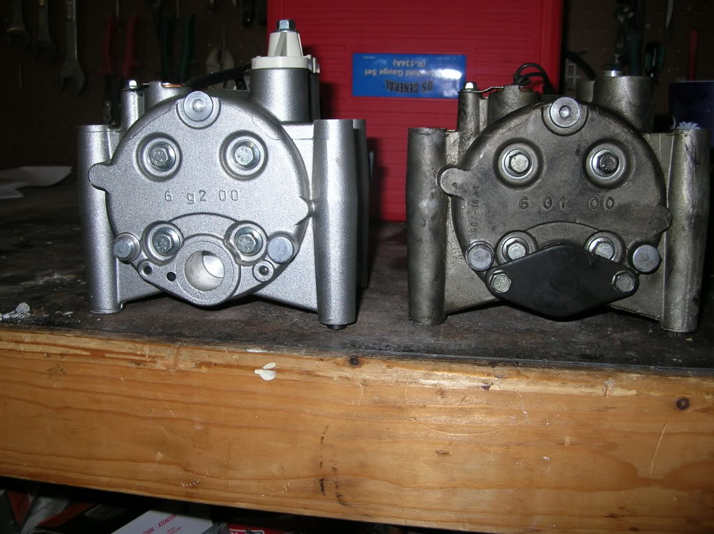

Old Jul 30, 2013 | 04:48 PM
Posts: 121,143
Likes: 6,654
The TSB is specific to certain models but it reportedly works on any of the compressors with the spring valve under the oval cover with two screws. (right side in pic)
You will have to evacuate and recharge the system to change the valve.
