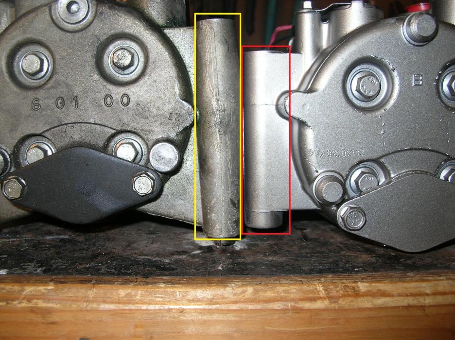

Here is one difference between the V6 and V8 AC compressor, the yellow rectangle shows 4" long bolt guides for the V6, and the red rectangle shows 3 1/2" long bolt guides for the V8.

Hi there foytech - to answer your inquiry - yes, the compressors between the V6 and V8 are different as Norri pointed out. Additionally, there could be a difference between the compressor used in our 4.0 V8 for the 2000 MY vs. the 03+ 4.2 STR... I had a similar issue in my S Type (same MY and engine) - my issue was related to a low freon charge.
Additionally, as pointed out - the TSB only applies to the V6 compressors. If your mechanically inclined - take out your compressor (it's a PITA) and switch the spring out and report back... maybe you'll get lucky...

here is one difference between the v6 and v8 ac compressor, the yellow rectangle shows 4" long bolt guides for the v6, and the red rectangle shows 3 1/2" long bolt guides for the v8.
to answer everyone's question on this. It does apply to both v8 and v6 compressors if(see that bolt on removable plate) if it has that plate it applies wether the tsb refers to it or not does not matter. The latter versions do not have that plate, just a cast sealed hole with no valve in there. It was totally eliminated. The v8 compressor will work on a v6 with spacers as depending on where/who you buy the comressor from, it comes with spacers for v8 use or leave them out for v6
now everyone take a timeout in their corners

To Brutals point:
New style compressor on left, 2005 OEM on right
BTW in the V6/V8 comparison picture, the compressor I picked up (the first one) did not come with spacers. I did in fact think about making my own but I found the correct OEM compressor online cheaper than the "short" bolt guide one.
