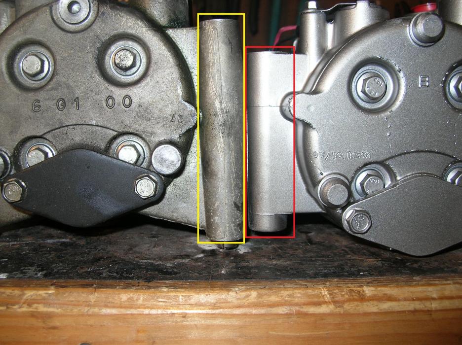

But here is the link: REMAN AC COMPRESSOR 2000-2005 LINCOLN LS V6 3.0 | eBay
These guys were great to deal with. Call them first to get the right AC Compressor!!
Make sure you order the 3 1/2" long bolt casing compressor!
Shown here in in the red rectangle..
