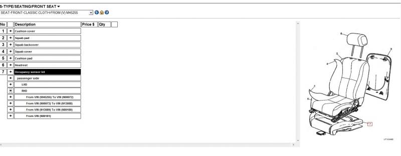

It requires removal of the front seat to check the harness connection and removal of the front seat cushion upholstery to replace the sensor - it's a pad in the cushion. The Parts Manual illustration shows the position of the sensor:
Slightly more complicated with heated seats but nothing too difficult other than being very careful with the leather.
