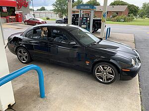

On my 2006 STR ive had a rough ride even after replacing rear wheel bearings. From hubs seemed tight. Well today I brought it to TWO road force balancers and the 2nd place showed me the bent rims.
so whats my best option here? Also, are 2006 STR rims CHROME? Because these are definitely chromed. And flaking.

Find a wheel straitening service in your area. I've seen some pretty amazing results.
Oh yeah..While you have the tires off the rims, Use a die grinder and disc to take the chrome off the inside bead of the wheel. The coating will continue to degrade and you will have air leaking every time a piece of chrome dislodges from the alloy wheel.

Use bead sealer to stop the leaks. I had two of the best rim/tire places here in the NYC metro area tell me that it was definitely my center section seal that was leaking on some rare 30 year old 3 pc rims I had restored. After using the bead sealer on bead portion of the somewhat pitted aluminum rim halves all the slow leaking stopped. I don't know what to say about the removing the chrome. I think dealers had them done as an option to dress up the cars. It's still available from manufacturers like LIncoln. Dumb, dumb idea IMHO. Curb rash is inevitable in urban zones in the NE with belgium block wheel grinder curbs. So are bent rims from crater like pot holes.
Get the rims checked and straightened if repairable. Let us know if they can remove then chrome. I'd be curious about that.
I'd suggest checking Tirerack for new rims if you're nervous about getting reconditioned OEM style rims but Tirerack seems ignorant about the two different rim widths?

Just to confirm the STR Jaguar 'Vulcan' rims are not chromed from new. They were however painted silver from new.

Thanks Mellow! This is what Ive discovered
So I have been able to find 3 of 4 rims. they were remanufactured. and yes they are painted and not chromed,
Still need one rear 9.5" wide vulcan though!
