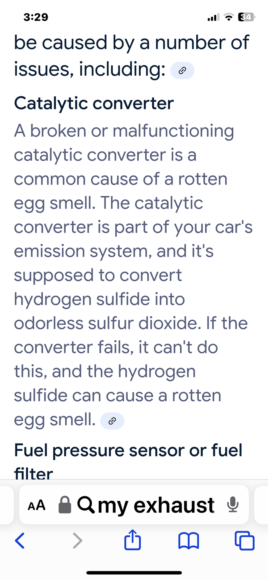

Ignore what I just said I just found this on the Internet;
Old Sep 16, 2024 | 01:18 AM

Yeah, I'm pretty sure they're baked. My mechanic, who inspected them, said the same.
