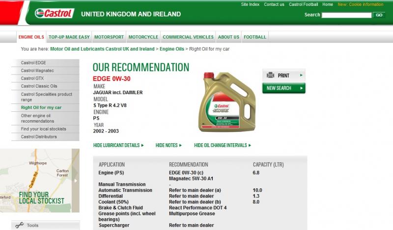

Here's the grade CASTROL recommend for the STR:
And that's as far as I'm going in a 'best oil' debate.
