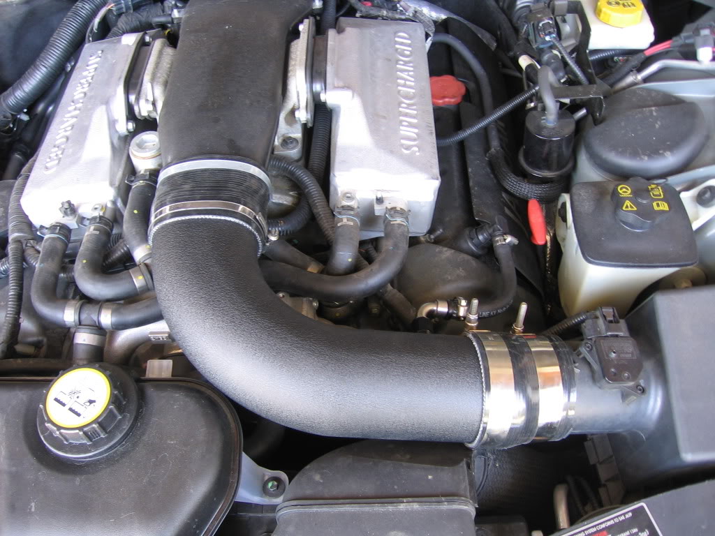

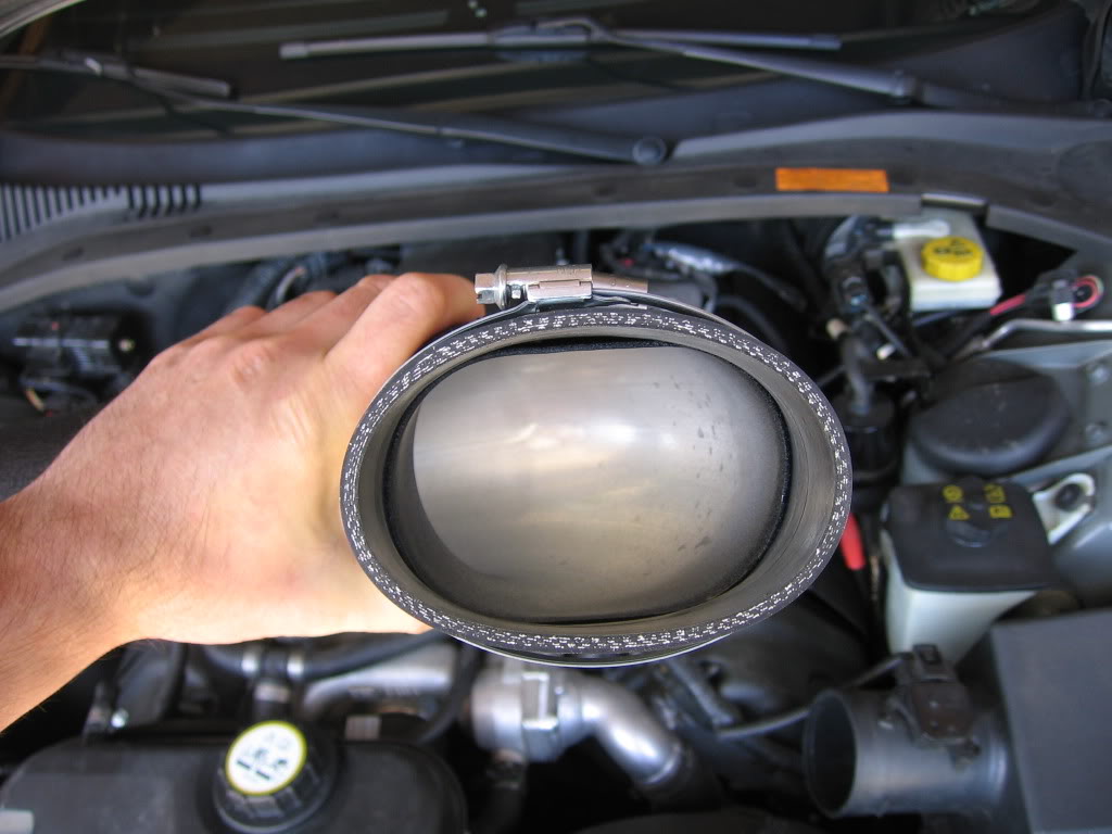

I haven't posted any pictures or specs yet, and I don't want to fill up qwiketz thread with this, so here it is. I finally got my intake after 3 months of promises and failure to deliver on the developer's end, but it was worth it in the end for my one-off custom intake. They used 3.5" tubing and ceramic coated it, as well as shaped the supercharger end to make it oval for better fitment.

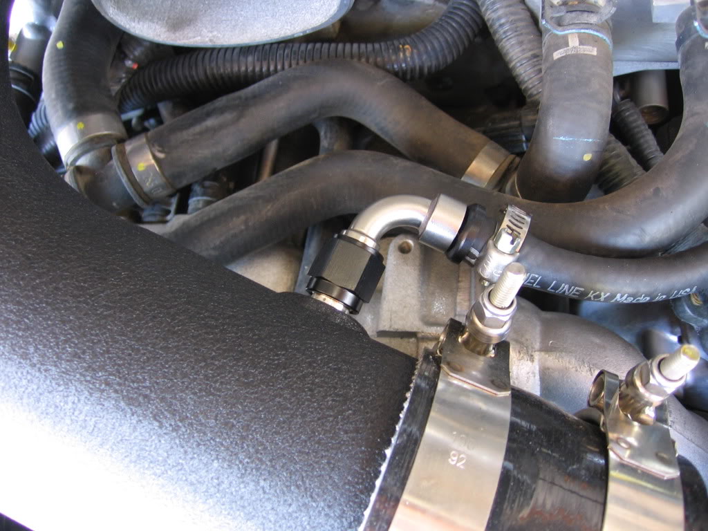

For the PCV hose, it has a 2-piece fitting welded on with a barbed ending. I replaced the plastic line with fuel line and clamped it, and reused the old ending out of the PCV valve.

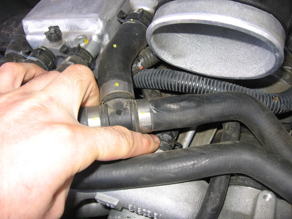

A couple things I ran into during installation were coolant hose clearances. As mentioned in the qwiketz thread, the OEM intake has grooves in it to help clearance. The oval end helps a lot, but it still rests against the hose.

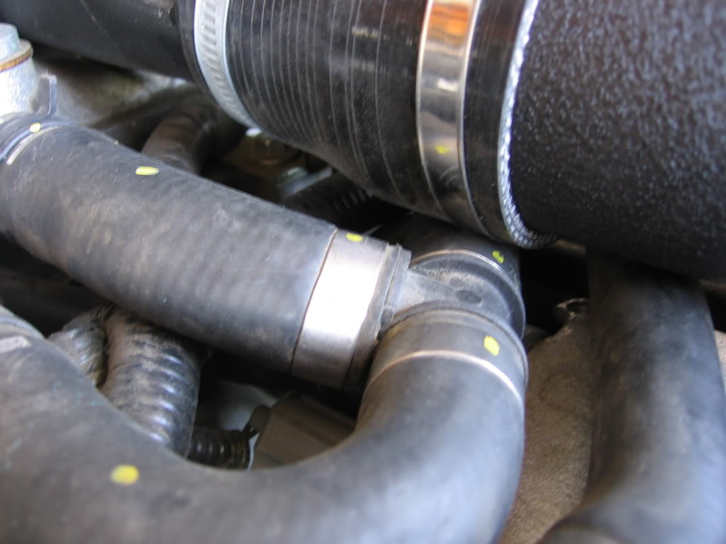

One thing I would recommend is to make sure the clamp on the smaller hose beneath the larger one which the intake rests on is facing down, as to help avoid pressure and possible slicing of the hose.

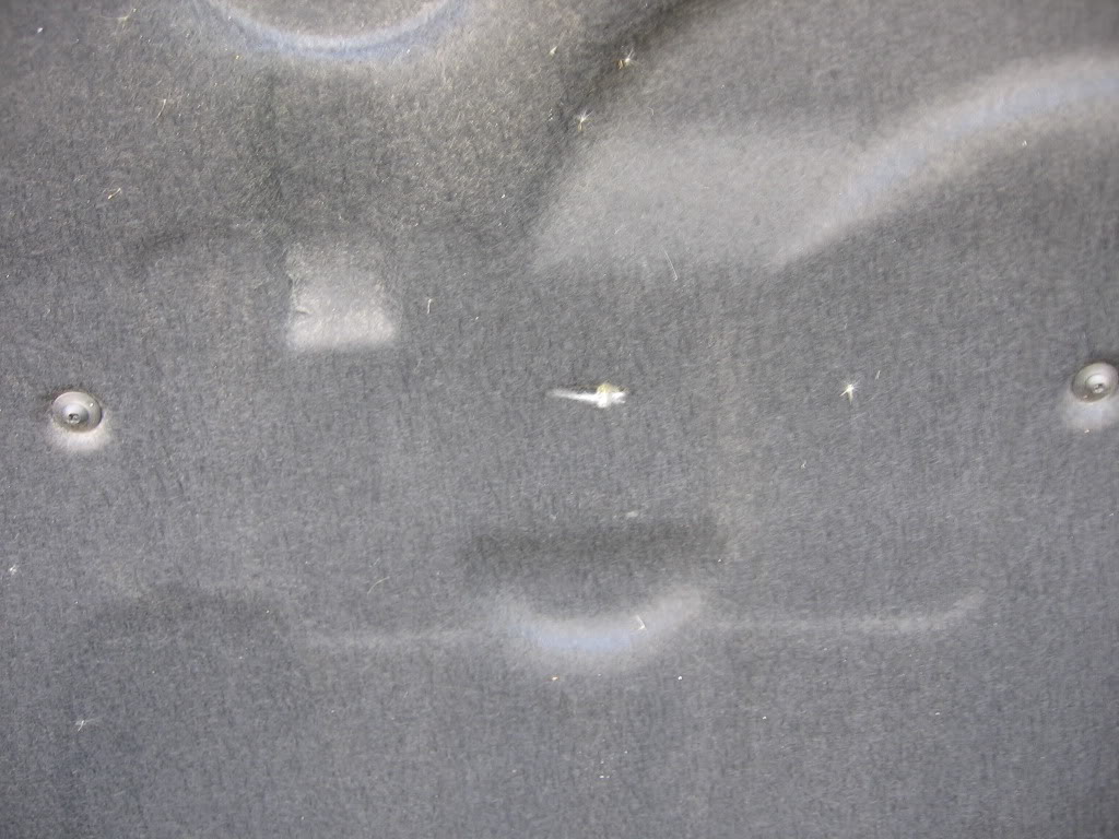

I also had to make sure the clamps on the supercharger end were rotated so they weren't digging into the under hood cover, which they were when I first shut it.

No dyno graphs yet, but hopefully soon!
