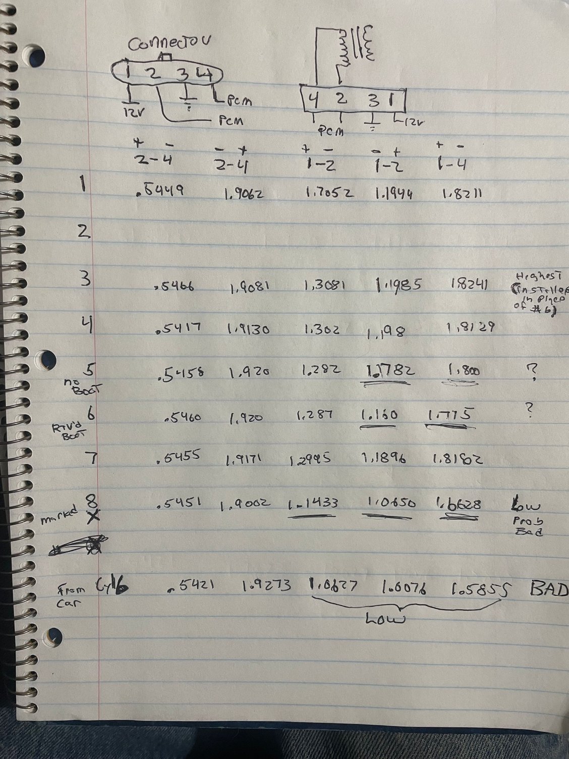

I had a spare car, so I had a whole set of coil packs. I took them into the house to try to put some numbers on them using my digital multimeter set on the diode mode. And I checked every combination with the leads, and One Direction, then reverse them, and did the same, and I put the readings on a piece of paper and looked at them.
somebody must’ve been in to the coil packs on the parts cart at one point because each coil I had a number representing its cylinder painted on the top of the coil except for two coil packs. One of the two coil packs had three white dots on it, and the other coil pack had a big white on it
Once I took all the readings of the spare coil packs, I checked the number six coil pack that was bad and it showed me which coils were good in which were bad
I grabbed the coil pack from the parts car that had the best readings and I installed it. I could tell as soon as I cranked it over that it was gonna be OK. the car fired up ran smooth as silk. The knock sound was no longer there. Thank God. the exhaust smelted better than ever. Took her for a couple of test drives and my check engine light went out and I hope it doesn’t come back on but so far it hasn’t.
ill Post a picture of the numbers that I got for measuring the coil packs and you can see that the numbers that are lower than the others are suspect coil packs. By the way, 06 STR had two different style coil packs in it I had six Denso, and two fomoco.
The parts car had all Denso
Hopefully this is helpful. Somebody has the same issue. It’s nice to be able to put a meter on it and be able to understand whether they’re not it means it’s good or bad.
