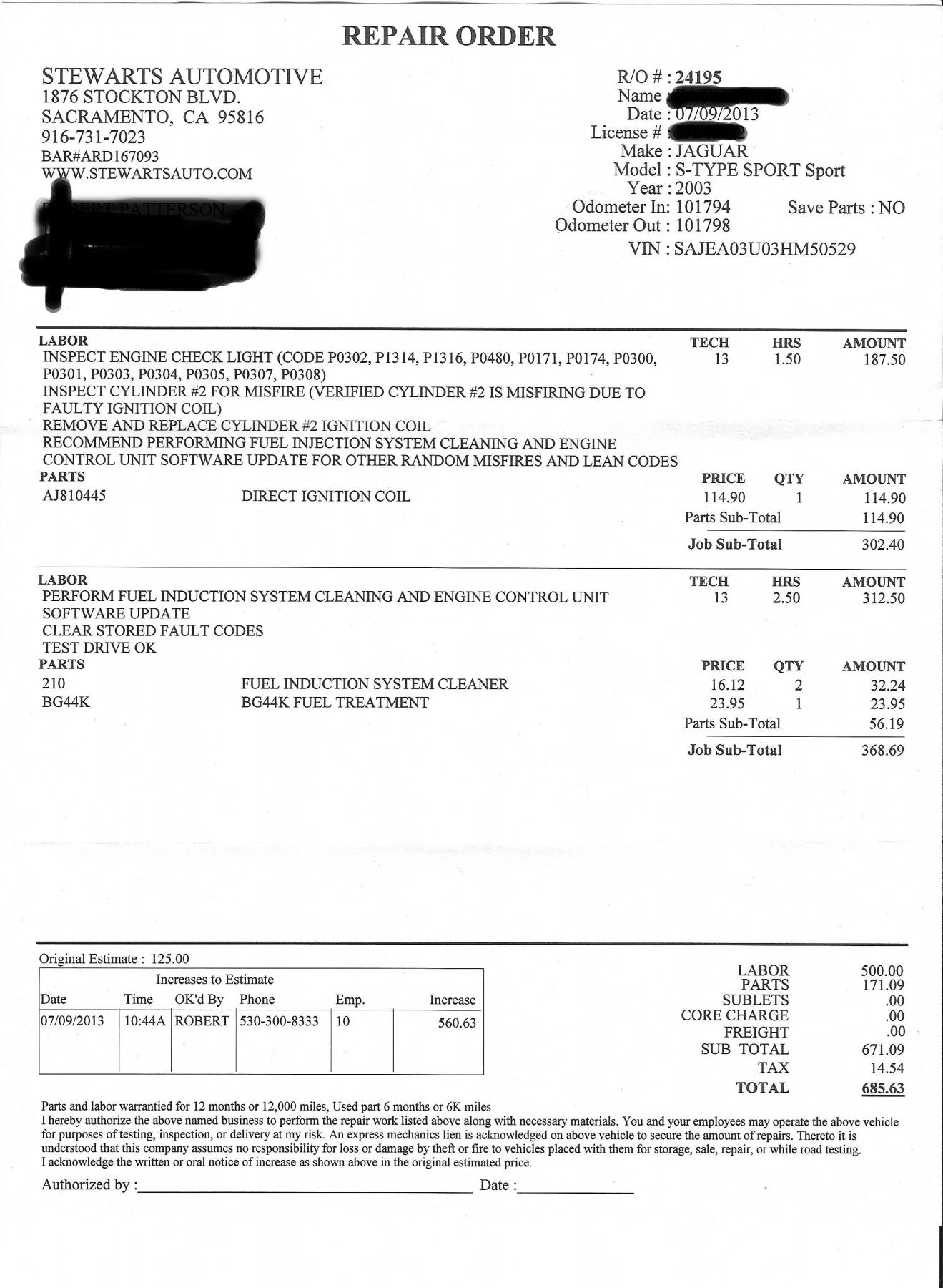

Slap me twice and call me Susan. I forgot that I told them to do the fuel injection cleaning. With that here is a copy of the bill. Does this seem like a fair price?

Old Jul 11, 2013 | 08:03 PM
Mikey's Avatar
Joined: Oct 2009
Posts: 11,057
Likes: 2,272
From: Perth Ontario Canada
OK 'Susan' it is.
The fuel system cleaning was probably unnecessary and of little benefit. On the other hand it did no harm.

What was on the "software update" that calls for 2.5 hours of labor? The fuel system cleaning is usually them hooking up a bottle of the cleaner to a vacuum line and letting the car run; I can't imagine that (maybe 20 minutes of work), clearing codes (5 minutes) and test drive (probably another 5 minutes) would warrant 2.5 hours of labor @125/hour. The update was probably doing something like plugging a scan tool in to the OBDII port and letting it download by itself mixed in with pressing a few buttons, taking a few minutes of actual labor time.

Sounds like they got me. Last time I visit this shop. I will say, I have heard in conversations with mechanics, techs and people I know that wrench that the fuel system cleaning is a pretty good thing to do considering how bad California fuel is.
Victoria is actually running better then when I bought her a few months ago. Don't know if thats attributed to the coil or the fuel system cleaning. She would always run a bit rough and had a slight shake at idle. Now I can't tell the engine is running at a stop and the drivetrain is smooth.

That sucks man. I hate to hear anyone getting taken advantage of. The slight shake I can almost guarantee was your coil going out. Expect the rest of the coils to fail at some point in the future. You can either replace them all right now, or replace them one at a time. The nice thing is you can tell when it is a coil as it runs rough, doesn't idle smooth, and might even completely cut out under WOT.
I suggest buying a cheap code scanner or at least going to Discount/Autozone/O'Reillys to have them read the codes first, then check with us here. This board is great on saving people money.
They certainly got you. California fuel is no better/worse/different than anywhere else on the continent. Old myth.
Modern gasoline has more than enough cleaning additives already, no supplements needed. Jaguar specifically recommends against them.

I just got off the phone with Stewart. He is a very nice and patient guy. He was very detailed in explaining to me all of the work done on my car.
As I stated in one of my replies I know that she is running and idling very smoothly now. Stewart explained that the difference between the before and after idle is due to the injection system cleaning.
Some of you say that the fuel injection cleaning is not necessary. Well, check out the TSB.
http://www.jagrepair.com/images/TSB/...0Injectors.pdf
