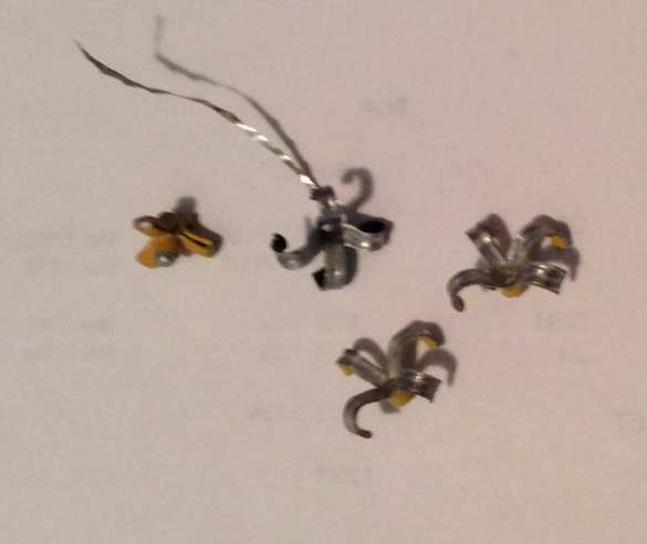

*Pretty things - see pic - when I opened the switch area top of boot, these pretty metal things fell out! One has a thin metal wire strip attached/
What are these? significant, or a present from the builders of the car?

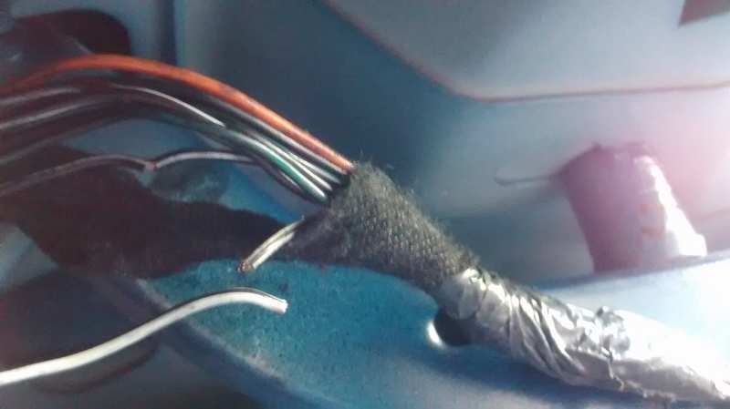

Default I found the problem!
Was broken wire in wiring loom right hand side of boot, under where the boot arm/support meets the car! - see pic!
Originally Posted by Mikey
Does your meter still show continuity when the switch is released? If yes, the switch is bad. If no, try bridging across the two terminal of the female side of the connector. If that doesn't turn off the light, suspect the wiring upstream.
Attached Thumbnails Boot Open- Trunk Ajar Warning Stays On! + Pretty Things?-brokenbootwarningwire.jpg
