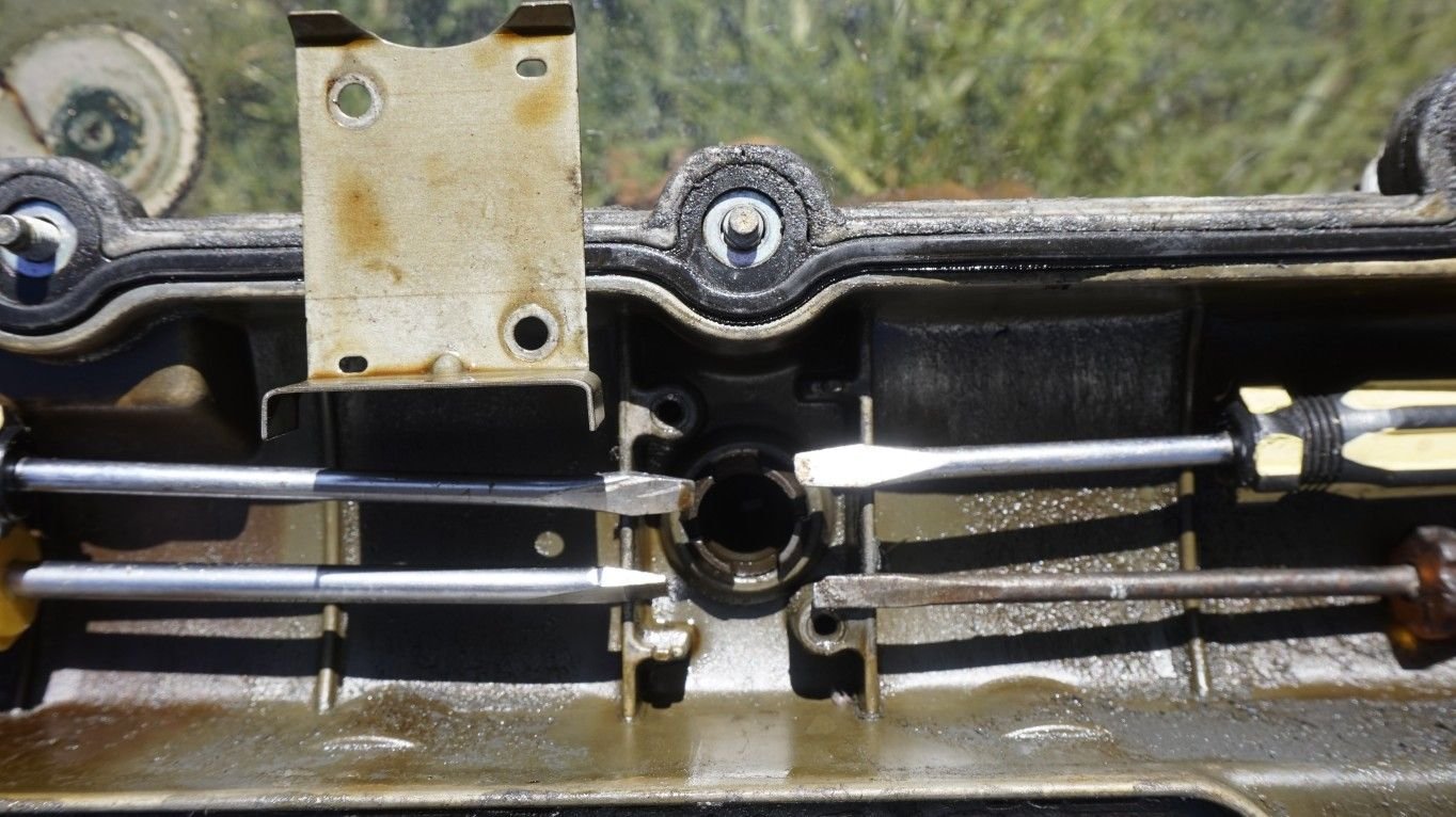

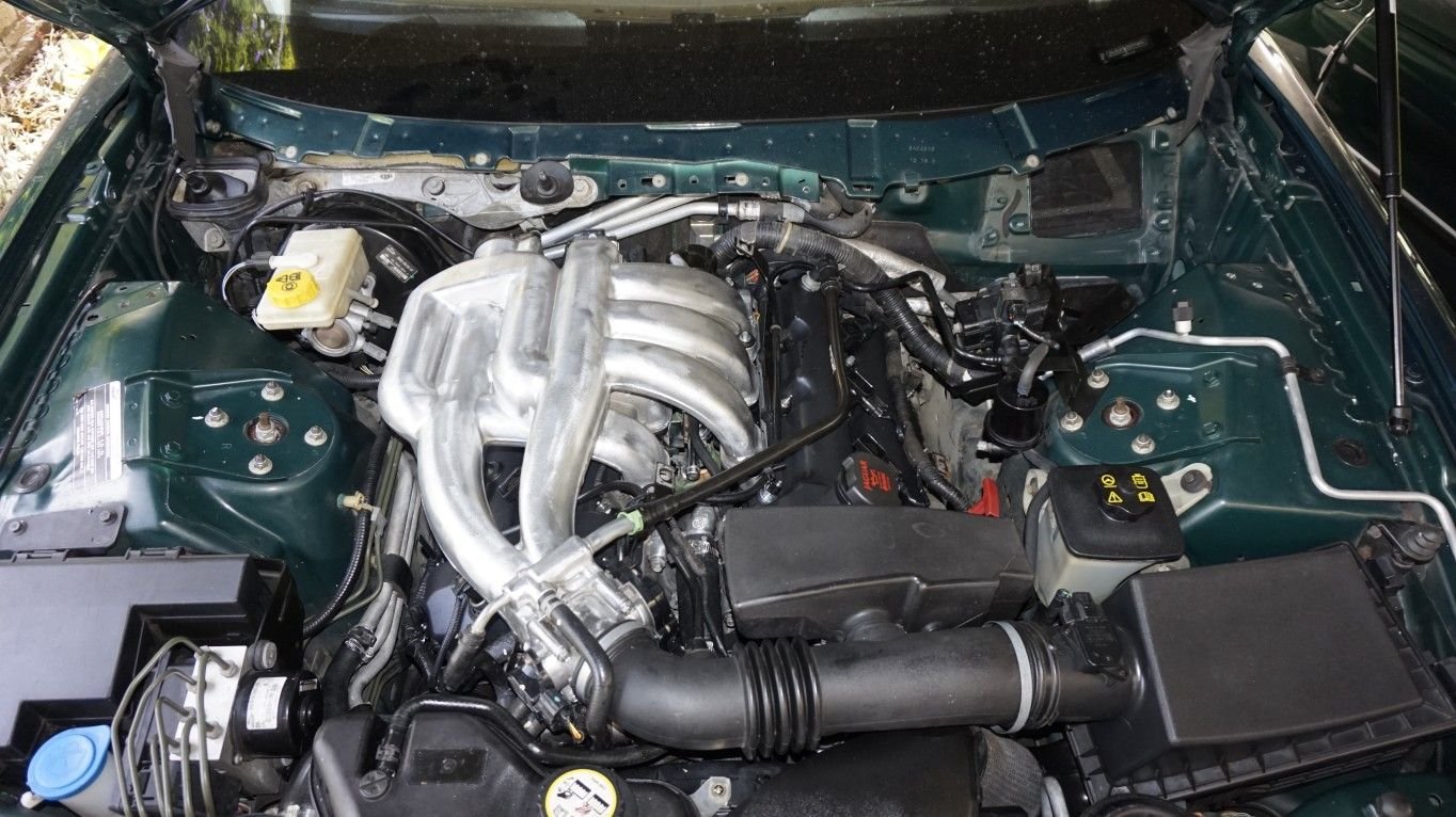

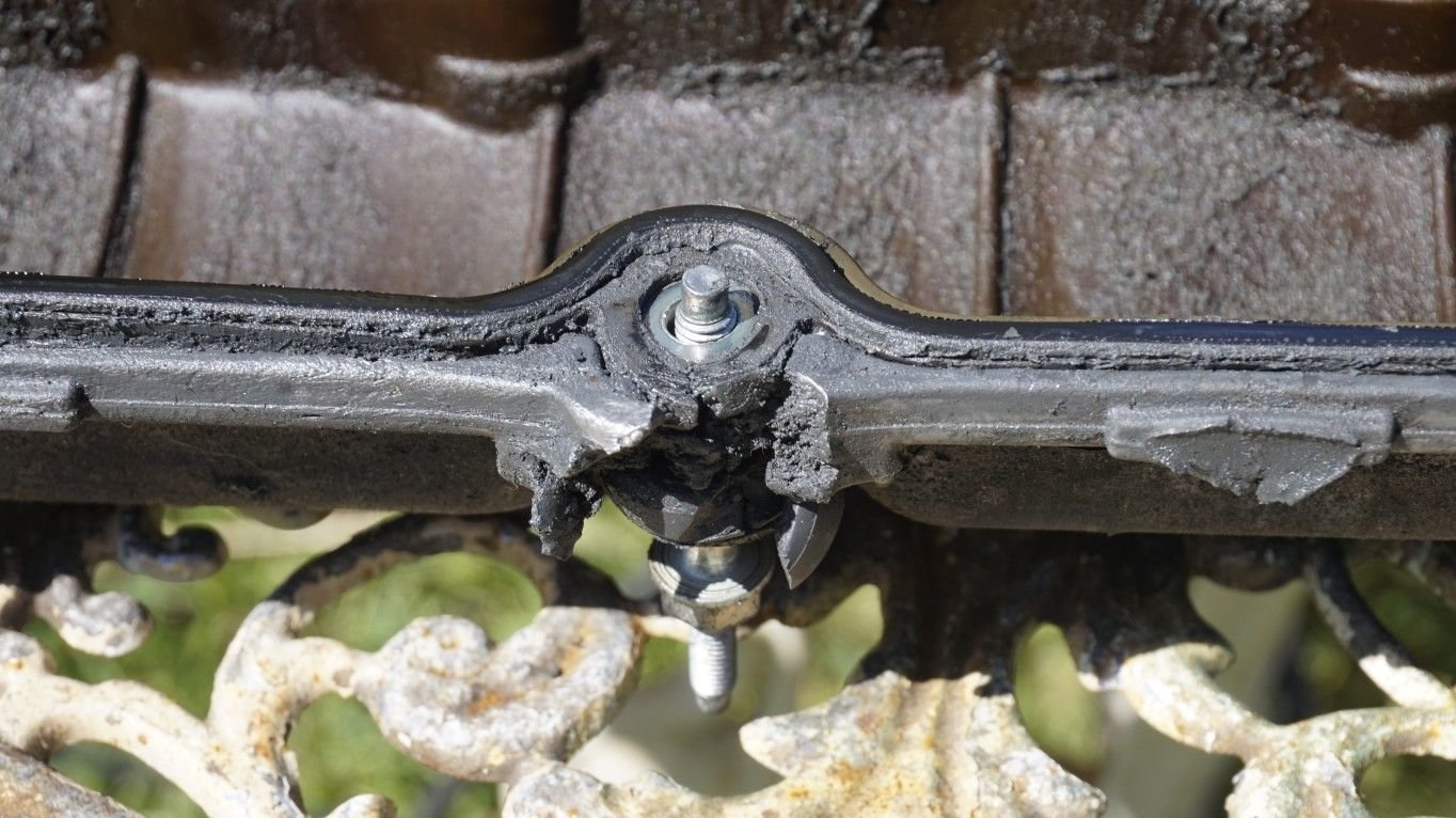

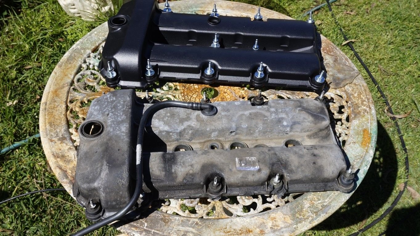

Hi, I wanted to give you all an update of how I went:
So I had the issue of cam-covers, which self-destructed after 18 years in the warm Australian climate (galvanic corrosion = Jaguar-design failure).
I searched and found sellers on Alibaba, whom I could talk into selling me some cam covers. I have now a little stock pipe of cam covers (4 left, 4 right) - just in case... The price was really good. When swapping those cam covers I cleaned up the engine properly, plus I did a lot of other repairs. I will start a separate link about the various coolant leaks I had and how I fixed them. Here just more pictures about the cam cover issue and the repair.

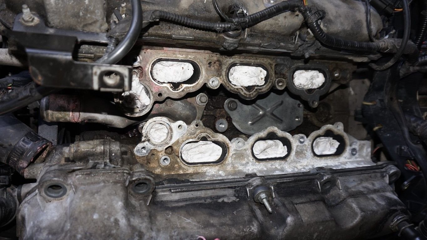

So this is how bad it was: Oil leaking left, right and centre. Spark plugs and ignition coils drowning.
The the engine block looked really sad.
This shows the worst of the galvanic corrosion self-destruction

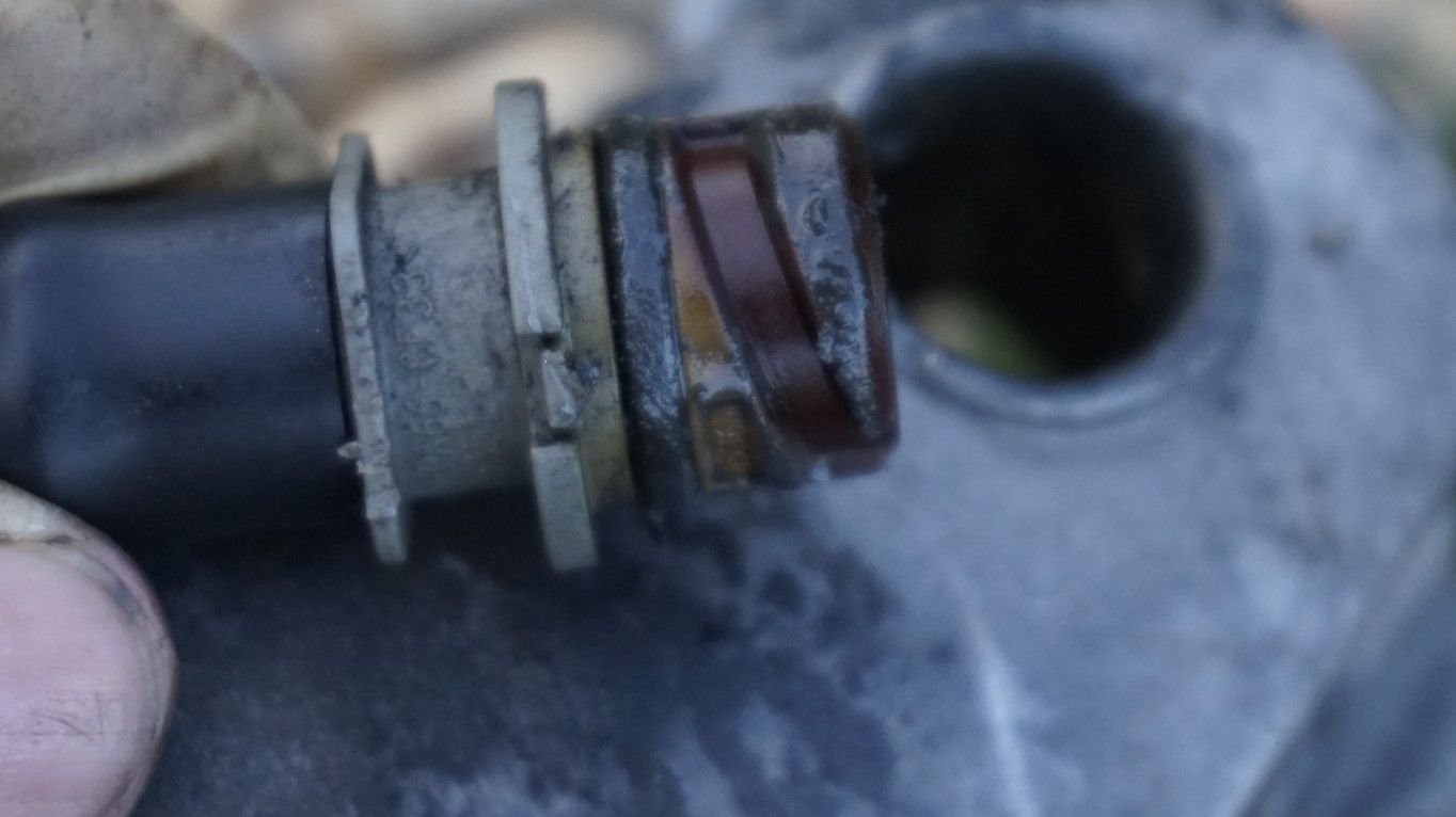

Old and new right cam cover: the breather hose needs to be "re-planted"...

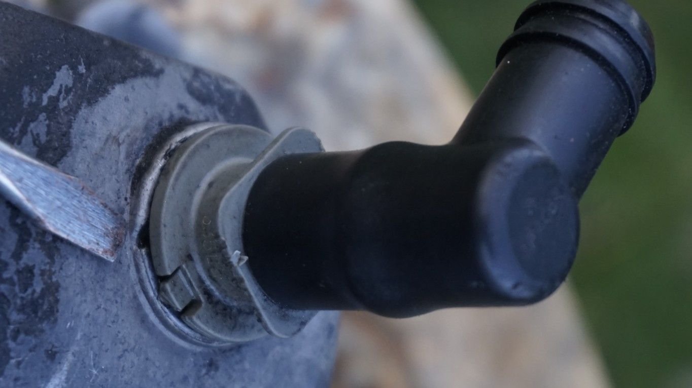

...and this is how to replant this breather hose: Carefully from underneath (after unscrewing a metal cover) you need to carefully press all 4 clips in simulaneoulsly to avoid damaging the breather.
And another challenge on the left cam-cover as well: This breather hose also needs to be re-planted to the new cover: Carfully lift that little latch with a screwdriver and turn the whole thing anti-clockwise...
...here you see the thread.

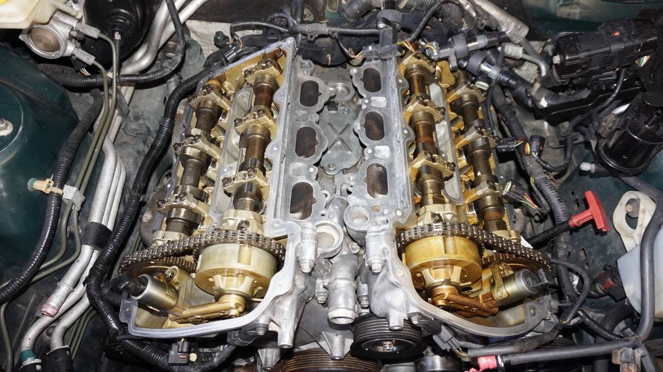

Engine block after cleaning. I had to rub off a lot of "magnesium-paste" off the cams: All that "liquified" magnesium, which came off the cam covers.
New upper & lower seals in injector-unit. New cam covers fitted.
And a shiny air-intake to crown it all. I cleaned the part with wire-brushes of all kind and covered it with clear-coat (=better then new).
This looks most certainly heaps better than before. No more oil leaking. The sellers on Alibaba could tell me only that the material of those new cam-covers is an alloy, which also contains magnesium - which percentage of magnesium they could not tell me. However, seeing that those new cam covers are properly coated I am not that worried about that. Hope this helps someone.
