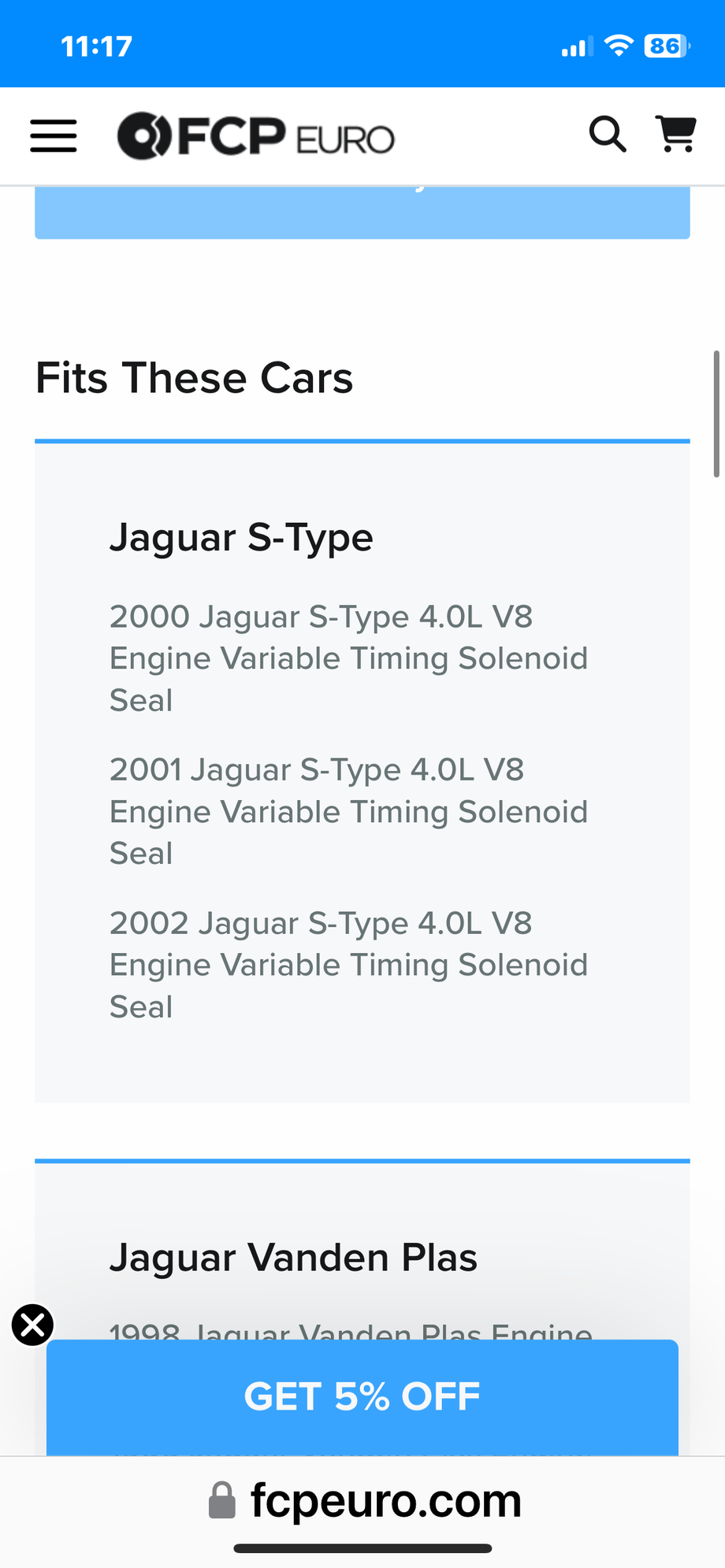

So one of the places I found the gaskets recently price was at FCP Euro www.fcpeuro.com/ and they had it listed for less than five bucks but of course they only list that gasket as being applicable to S types from 2000 to 2002 for the 4.0 engine. Not the 4.2 sc
I figured that the same solenoid was common among every Jaguar that used VVT solenoid and the likelihood that they’ve changed gaskets is slim to none and at the low price of $4.79 what do I have to lose so I bought two.
Fcp euros applicability list. FAIL!
Guess what? they fit
