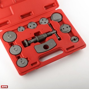

Rear brake calipers come in many different shapes and sizes. I've tried cheap adapters and they don't work too well. Especially if the calipers are stuck. You should be able to find an adapter at a local parts store or other stores that sell automotive tools. I have a set similar to the one in the picture and it works great.
Attachment 42951
2000Jaglvr, would you happen to know a part number? I figure I'll just buy it and either DIY or get my mechanic to give it a go. Thanks

Bklynchris, Six Rotors has a part number that works for his. See post #10 above. Try to find that one, or go to your local parts store and see if they have one you can borrow. I think most parts stores have tools for rent or to borrow these days.
I don't have a specific PN for a Jag adapter. I bought a full set from SnapOff tools years ago when I was wrenching at a dealer. The picture I posted was from Sears. It's one of many they sell but it did not list Jaguar as a make that was supported.
