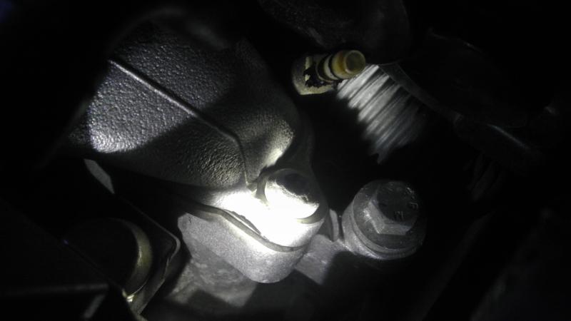

Well upon doing some inspecting I found I had some moisture up underneath the cowl and traced it to this fitting. Its on the drivers side just under the throttle body and TPS. Anyone have any ideas if this is a vacuum line and where it comes from. I havent ripped enough apart to see it that well this was taken with my phone cause it was the only thing I could fit down there for a pic. Still hot from running so gonna have to wait to start removing stuff. I'd like to try and get out and pick up the line if I can find out which line it is so I can just do a breakdown and replace. Any ideas??

Thanks aholbro1 once I figure out what is supposed to be attached to the fitting in the pic and get that fixed if the problem is still there then looks like I'll start playing with the MAF.

Chris, with the motor running, does the fitting suck (vaccume)?

Well reattached it was a vacuum line from the S/C inlet to the I believe fuel sensor if I remember correctly according to the vacuum diagram. I got it reattached and also cleaned the MAF which did have a little bit of a build up. Reset the engine light and will see what happens. I'll keep this updated.

I dont know what popped it loose but I'm assuming because of the way it fit together after that it just worked its way loose. I ended up using electrical tape just to secure it better when I reassembled. Here is the line that popped off this is what I traced it to and looked at the vacuum diagram under the hood to figure out where it went.
