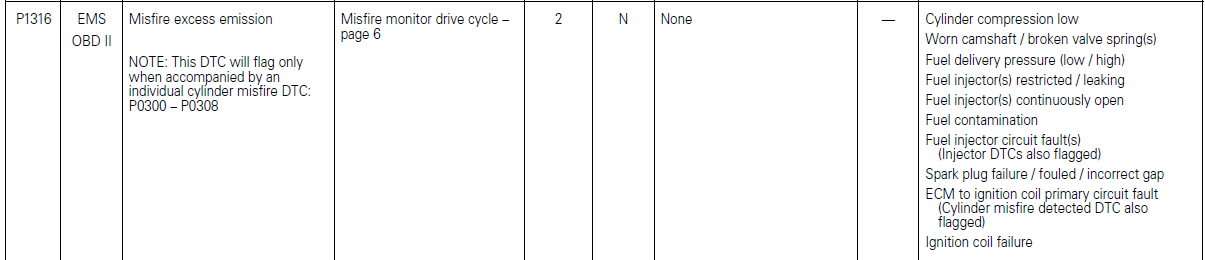

Have you looked at the forum stickies to see what those codes mean?
Since you think the coil is good you need to look further down the list of possible causes. Codes are just a begining or a direction to look in. It's not black and white for many codes.
Note; The list has coil failure at the very bottom.
Attached Thumbnails Confused and Tell me if this makes any sense?-p1313.png   Confused and Tell me if this makes any sense?-p1316.png
Thanks, by now I know these by heart. I have an Alldata account. I had the shop check all the injectors and especially the one on #3- zero problems with anything related to fuel delivery. Spark plug and coil on #3 were new on July 11, showed no problem, no oil, no nothing, but replaced them anyway. No indication of compression problems and nothing mechanical with camshaft or valve springs
. Any other ideas. Interesting that on ALLDATA the list is in reverse of the list here with ignition coil failure at the top.
