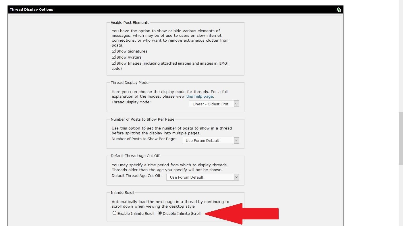

I always check the date a thread was posted shown in the top left corner before replying:
The reason we are all seeing ancient threads and posts appearing to be recent is the recent Infinite Scroll feature which links seemlessly through "relevant" topics. This spawn of the devil can be disabled in User CP:
Go to User CP - Your Control Panel - Settings & Options - Edit Options. Go down to the Infinite Scroll option box and check Disable Infinite Scroll. Finally go all the way down to the bottom of the screen and click on the Save Changes button. You will no longer see ancient threads in your browse.
