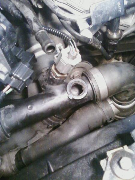

Hello all, I've got a coolant leak and fortunately the source wasn't too hard to find. The hose from the reservoir is broken where it attaches to what I believe is the thermostat housing. Is there something that goes in between the hose fitting (on the left) and the housing (on the right) or is the threaded nipple that screws into the housing broken? I'm assuming it's just broken and I need a new reservoir hose and somehow have to remove the broken nipple from the housing.

You will need to replace the upper hose as the bleeder and connection to the expansion tank are included. The broken fitting in the hose will need to be removed and discarded.

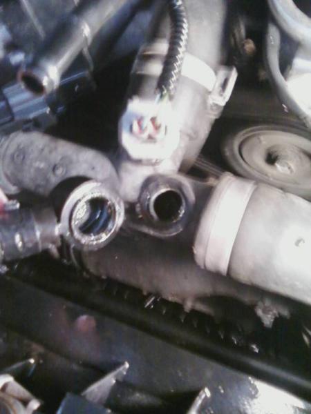

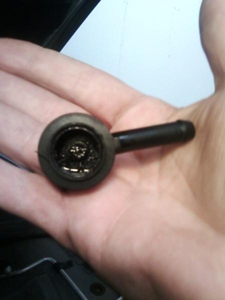

Ok. I finally got time to start on this and now it doesn't look like the upper reservoir hose is bad. It's the plastic connector that fits into the end of the hose. The elongated end inserts into the hose and the round end fits (threads?) into a plastic tee fitting. I've attached pics of the parts in question.
1. This is the plastic fitting that was inserted into the end of the upper reservoir hose and appears to be broken.
2. This is the upper hose that seems to be in good shape.
3. This is the plastic tee that the broken end of the fitting is inserted in to.
Is it possible to just get this plastic fitting? Does this part have name? Part number?

The part you indicate is broken off is not a separate service part by Jaguar as it is part of the upper hose.
The part number is XR854920 and, depending on the VIN of your vehicle, may have been superseded. Have the VIN of you vehicle available and check with your local Jaguar dealership for the correct replacement hose.
