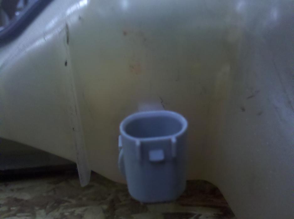

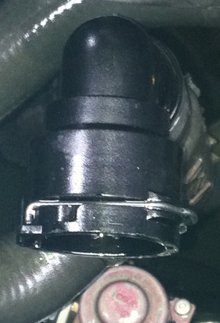

Ok got everything off. The level sensor part I got off by turning the white plastic piece counter clock-wise (facing from the front of the car) and then pulled down. The white piece probably detaches from the black piece, but don't want to test that theory (i.e. break it) until I get the replacement. Unless anyone here knows? The other clamp underneath has a C shaped metal wire piece on it. You can probably make it out in my photo. The opening faces the passenger side, so to get it off push towards the drivers side. I hated having some of the coolant pour onto my car and then on the driveway, but didn't have any choice in that matter. Looks like the rest should be easy. To those of you that have done this one before, do I just fill up the reservoir and run the car and then keep refilling until at the full marker, or do I need to do something to get air out of the system? I would run JTIS but I'm on a Mac.
Thanks for all the help so far everybody!
Attached Thumbnails Coolant reservoir tank replacment-clip.jpg   Coolant reservoir tank replacment-level.jpg
Old Mar 27, 2011 | 04:21 PM
sjuraud's Avatar
Joined: Jul 2010
Posts: 43
Likes: 135
From: Atlanta, GA
Ok, I zoomed in a cropped the photos to give a better view of these two parts.
Attached Thumbnails Coolant reservoir tank replacment-clip-detail.jpg   Coolant reservoir tank replacment-level-detail.jpg
