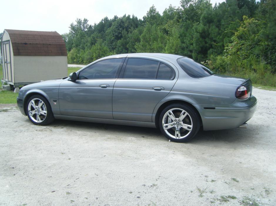

Well I wanted the de-ambered look and seeing how all I could find was smoked side markers I decided to try using VHT Nite shades. For those of you that dont know what that is its a translucent black paint that you paint lights with so the light still shines through. Well did it last weekend on the bumper markers and the side markers and it actually doesnt look too bad. I wish it looked more smoked which I'm sure with less coats it might look that way. I also wish it was more glossy. But overall I am satified. If anyone is looking to do this make sure you follow the directions and put no more then 3 coats cause I only put 3 on and they are dark. Later tonight I'll get a pic of the lights on so you can see how they still let some light through.
I do think the de-ambered look makes it look more sleek. My wife even said when she came out after I was done, she wanted to know if I had lowered it some.

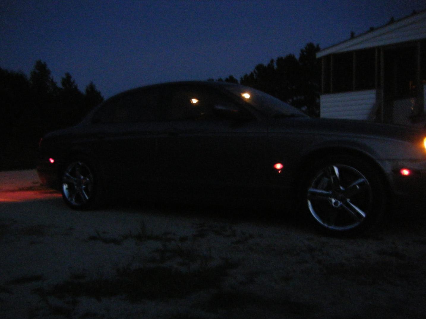

Here are some pics of it at night. It is alot dimmer during dusk hours but it is still very effective at night and still illuminates through good enough.
Attached Thumbnails De-amber my STR with Nite Shades...-dscf8452.jpg   De-amber my STR with Nite Shades...-dscf8454.jpg   De-amber my STR with Nite Shades...-dscf8455.jpg

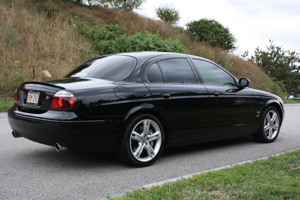

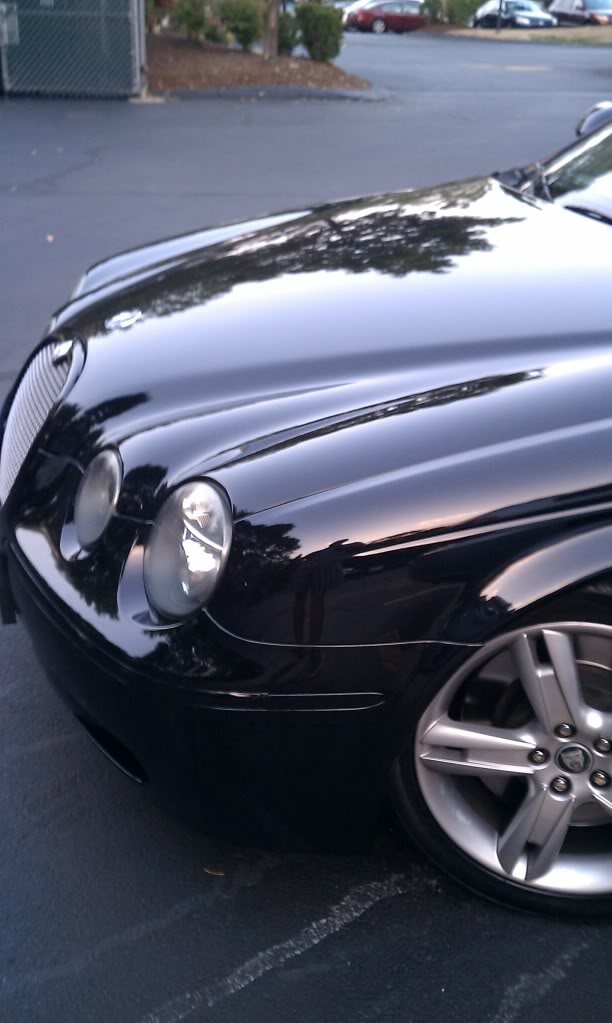

Ok its done, I became super **** while doing this and I kept sanding them down and re-painting. I only have pictures of the fronts, the rears were drying. Couple tips/observations that I had noticed.
1) If you can get away with it, only use 2 coats. My front orange lights pretty much look red when lit. Is it legal, no idea, are the cops gonna bust my nards because of it, we shall see.
2) If you have any imperfections such as rock chips or indents, sand them down as much as possible. This paint is almost like a laquer enamal and it will show. That is why I ended up putting on so may coats, too many in my opinion.
3) DONT USE CLEARCOAT. Does not dry well on top of this paint, another reason why I sanded them down and re-painted.
4) Dont break the tabs taking them out, all were in tact except for two top ones that snapped on one of my rears. That suprised me seeing as I somehow squeezed both sides and didnt "yank" them out.
5) It looks awesome during the day.
6) If you end up re-painting/re-sanding, take the time and use a high grit sandpaper, dont go down to lets say 100ish just to get the paint off quicker. Will take more pics when I have the rears on.

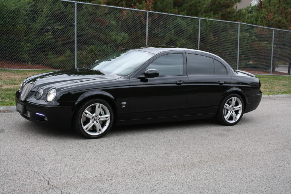

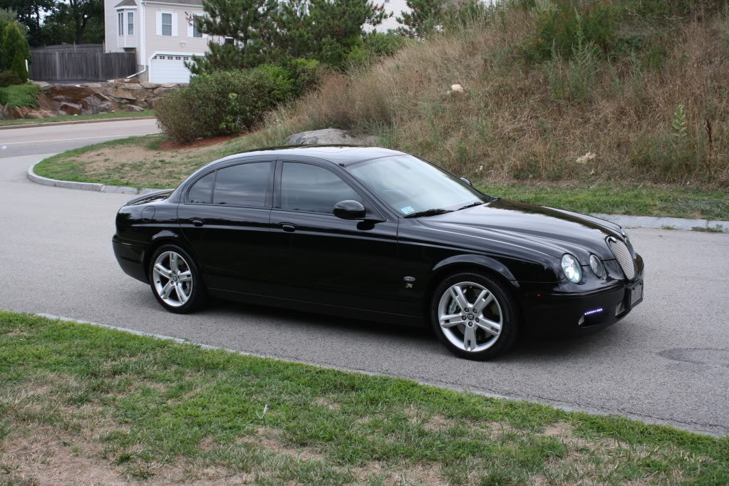

Heres the final product, Vance was right the fronts do still have a slight tint of orange after comparing the rears once installed.
