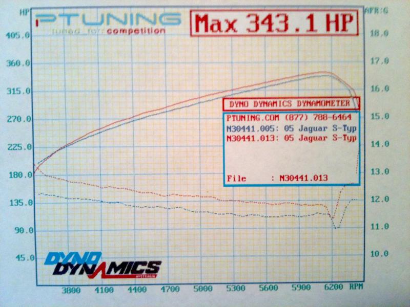

Some of you who have posted to this thread know that last month I had before and after dynos run with my STR following an exhaust modification. After my second dyno, the shop's tuner and I had a conversation. First of all, he said "our sc engines appear to be extremely consistent when under full load". I asked him what he thought about the fuel to air ratio measurements and he said this. "Your ratios for the first dyno are a bit rich to achieve maximum power for a sc engine across all rpms." He then stated that "Your ratios after the exhaust modification were more ideal for maximum power. The exhaust system may have leaned out the system due to higher/better flow - - yielding more power - - more area under the curve across the entire rpm range."
2005 Jaguar S-Type R Exhaust Mod on Dyno Dynamics dyno - YouTube
I have been searching, but not locating, other STR dyno air to fuel ratios. Do you guys have any data you can post or send to me via PM? I have not researched 4.2 XJRs yet but plan to. Shouldn't an XJRs ratio be essentially the same as a STRs?.?.?.

Thanks for posting the dyno sheet...Man, you're close to the limit, stock on a your AFR (air fuel ratios)...A lot of people tune to a conservative 11.5 with 12.5 being very aggressive...Also interesting to see the AFRs progressively declining, that could mean the car is pulling timing...Also that was only one gear, while generally you can expect the AFRs to be similar in each gear, it's important to know for sure...
What this means, if you're running AFRs near 12.5, there's nothing to tune on the fuel maps/trims...Timing and redline shift points are where the big gains are...I'm now really interested to dyno my car so I can see what AFR puts down on a STR with only 3lb pulley...
