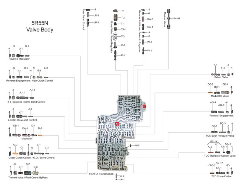

I had the dredded p0795 and from everything i read it was the 4-3 prestroak spring...You were all right, it was broke in 5 pieces. I successfully got it changed out...but when the valve body was out the ***** fell, i want to make sure they are in the right places. also after re-assembely i added fluid and struggled with checking the proper level. it would pour out and I would add until it flowed, but it was still way low. i added, ran the car and added more, removed the screw and waited until it flowed. but if the ***** are in the wrong spot then it would flow out of the valve body...i have attatched the picture you guys had but added red where i put the *****.Name:  valvebody.jpg

They Starred out the main point and question. i meant little round things but they dont like those being talked about. if anyone knows where they are supposed to go please let me know.

can you but the pic back up so i can see the vb prestroke valve spring location on the vb am replace my also 5r55n s-type 2000 4.0
