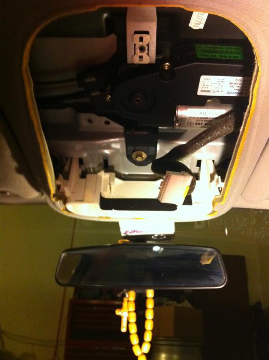

Now onto the swap:
First open your sunglasses holder and look up, there will be a single t15 torx screw, remove it.
Now take a pry tool and slowly start prying at the front of the console by the rear view mirror. You have to release the 4 clips around the dome light. You do not want to release the 2 rearward clips (actually you really can't. This may require more force than you are initially comfortable with. It may feel like it's going to break, those clips are TIGHT. As you release the front of the console the dome / map lights will go out. That's normal and by design.
Once you have the 4 clips off, SLIDE the console forward and down. Basically there is a black plastic piece seen in this pic, that attaches to the two rear clips. What you want to do is slide the console forward so the back edge and sides of the black plastic piece clear free of the headliner. This will make more sense when you do it.
Disconnect the electrical connector by pushing the tab in and then pulling the plug out. At this point the console should be completely removed from the car.
Now take a flat blade screwdriver and push in sides of the the two metal clips in the back and take off the black plastic piece, there are also two smaller clips holding the outer grey shell onto the inner black plastic, they are just tabs pull them back a bit and they will come off. Once you have the black plastic piece off, set the old console aside.
Now time for reassembly. It's a bit different than removal.
First, take the black plastic piece and put it back in the roof underneath the headliner. Line up the screw hole and put the t15 screw back in place.
Then plug the electrical connector in. At this point you may want to turn the key on and test the switches. My sunroof switch, etc all worked fine. Press a button on the homelink. You will see a red LED come on.
The dome / map lights will NOT work until you have the console back in the roof.
Once you have confirmed that you have power, line the front clips up, and slowly but firmly push all the clips into place and snap the console back up into the roof. (The rear clips will once again attach to that black plastic piece that is now screwed to the roof).
That's it, your car now has homelink.
