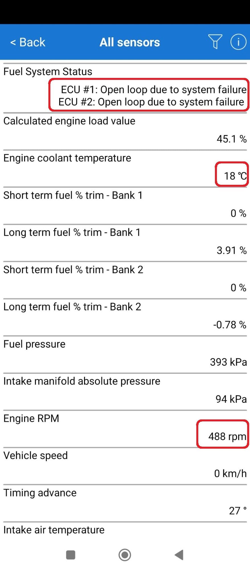

I have exactly the same problem. My car, 2.5 petrol, does exactly the same when the engine is cold.The engine idle drops to 500 revolutions, sometimes increases to 1000, then decreases again. It seems that the shock does not activate.I also noticed that the first brake pedal is hard when the engine is cold. It's probably a vacuum loss. When it's cold outside (this morning it was -17 degrees Celsius) it's bad. In summer, it feels very little.

I checked the hoses.On this forum, I read that it could be the seal from the hose that creates a vacuum at the brake booster.
I use the Car Scanner application with OBD2. Tomorrow morning I will take screenshots of the measured values.

Hello,
As I said yesterday, I recorded the data when the engine is cold (after a few seconds after starting) and after 10 minutes of idling.
PS I think the title of this thread is not appropriate, because I don't think the ECU has a problem here

  #40
JagV8's Avatar
Posts: 27,546
Likes: 4,923
From: Yorkshire, England
Cold engine trims are inevitably rich - rather like using a choke in the old days.
Open loop trims are junk (it's open loop!).
Do you have P1111 or P1000? If the latter, which OBD monitors are unhappy?
