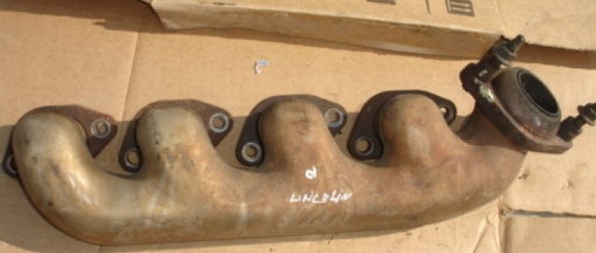

I re-read your post and I was incomplete in my answer. I "think" the exhaust manifold gaskets are the same as the LS. I know the heads are the same between the reg 4.2 and the SC 4.2.
Here is a STR manifold and a Lincoln LS manifold. They look real close to me?? The Jag has two ports connected on the flange where the LS has 4 individual flanges.
The LS manifold;
The STR Manifold;

Though the STR has the ports connected on the flange, looks like the bolt pattern remains identical. Wonder if there is casting slag or other restrictive ridges? Thanks otherwise clubairth.

Yes we know the bolt pattern is the same just not completely sure about the gasket. It should be OK but I hate to have people buy parts when it has not been done before!

I believe I read that the exhaust manifold gaskets are identical too.
