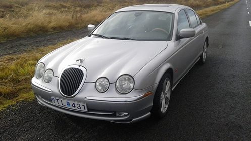

hello
new here
just got a 2001 s type auto 3.0 (us model)
love the car so far
i do have some electrical problems
passager window not working
both mirrors are bot working
doors switch do not illuminate(not sure they do but most of the car do )
so has the lights on bottom of doors (dome light works)
truck light do not work
left licence plate light not working went the trunk is open
fuse are good
can he be a bad ground ???
thank you
