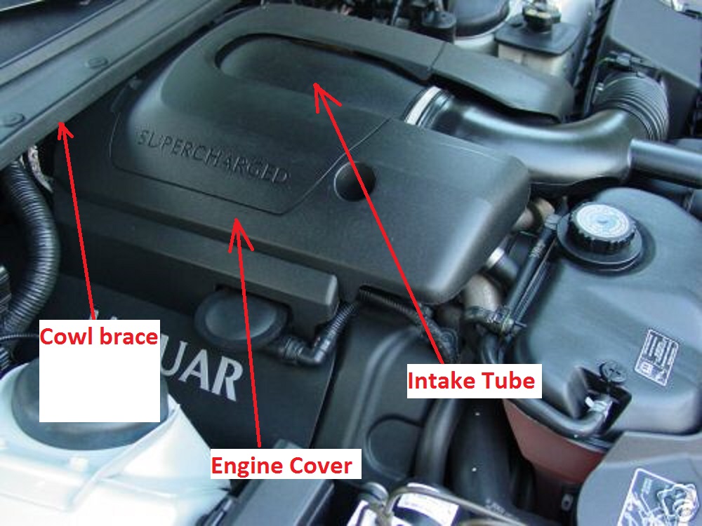

Something does not make sense? That has NEVER been reported before on any super charged 4.2L engine and they are all the same.
The intake tube is under the engine cover which goes under the brace on the STR.
So for the intake tube to even touch the brace means you could not fit the engine cove in place. How could this happen?
Does your engine have the cover in place?
Take a look;
https://www.jaguarforums.com/forum/a...1&d=1474123245
Junk forum software again! No way to insert picture. It just stuck in a loop as usual! Sorry for the small picture.
Take a look;

RE the rubbing and photo: yes there is a way and I will take a picture for you. It may just be me but then someone had to have made a major modification to the engine that is not supposed to be like that at all.
Which is why I asked how everyone else's was set up.
