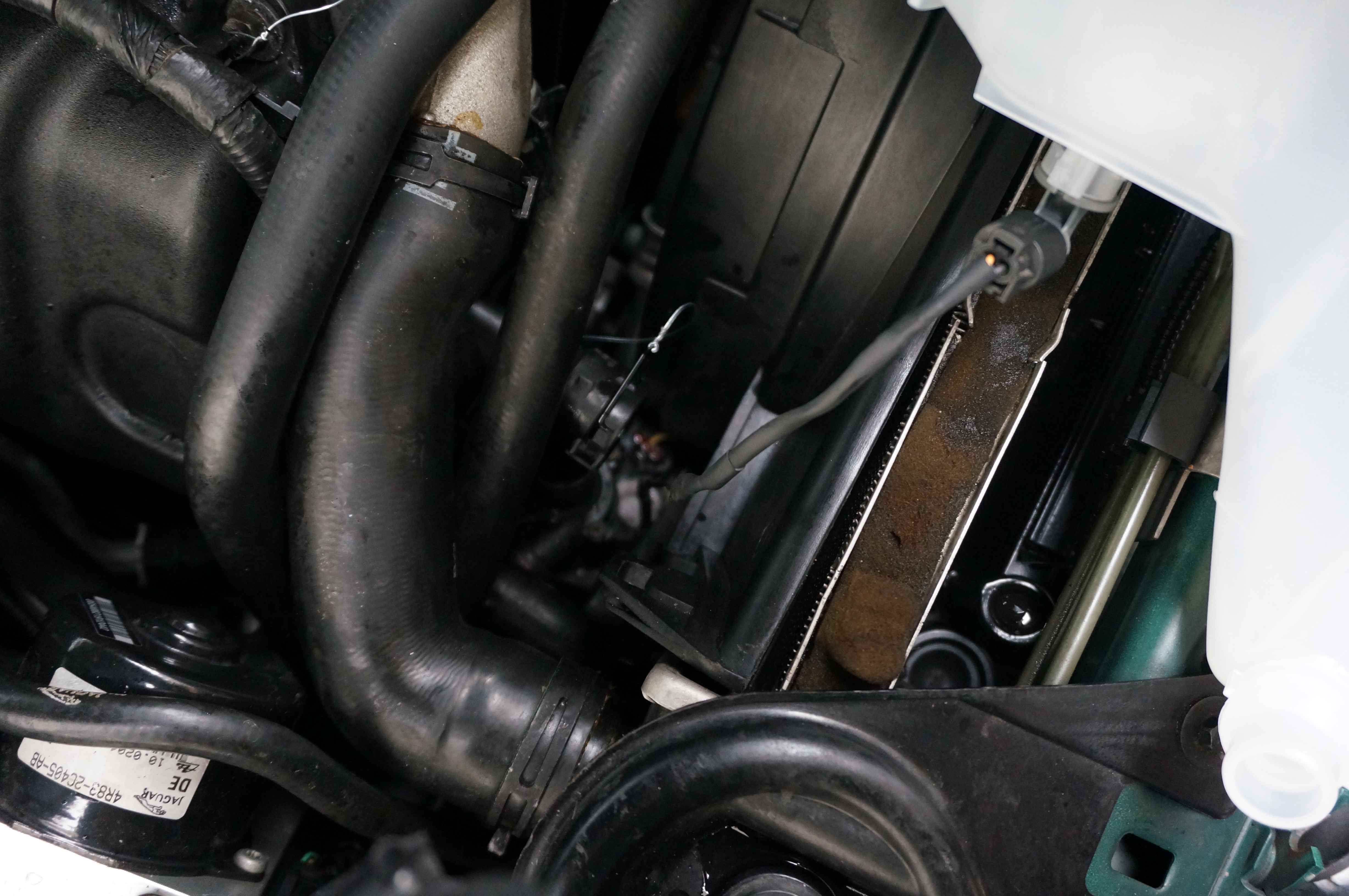

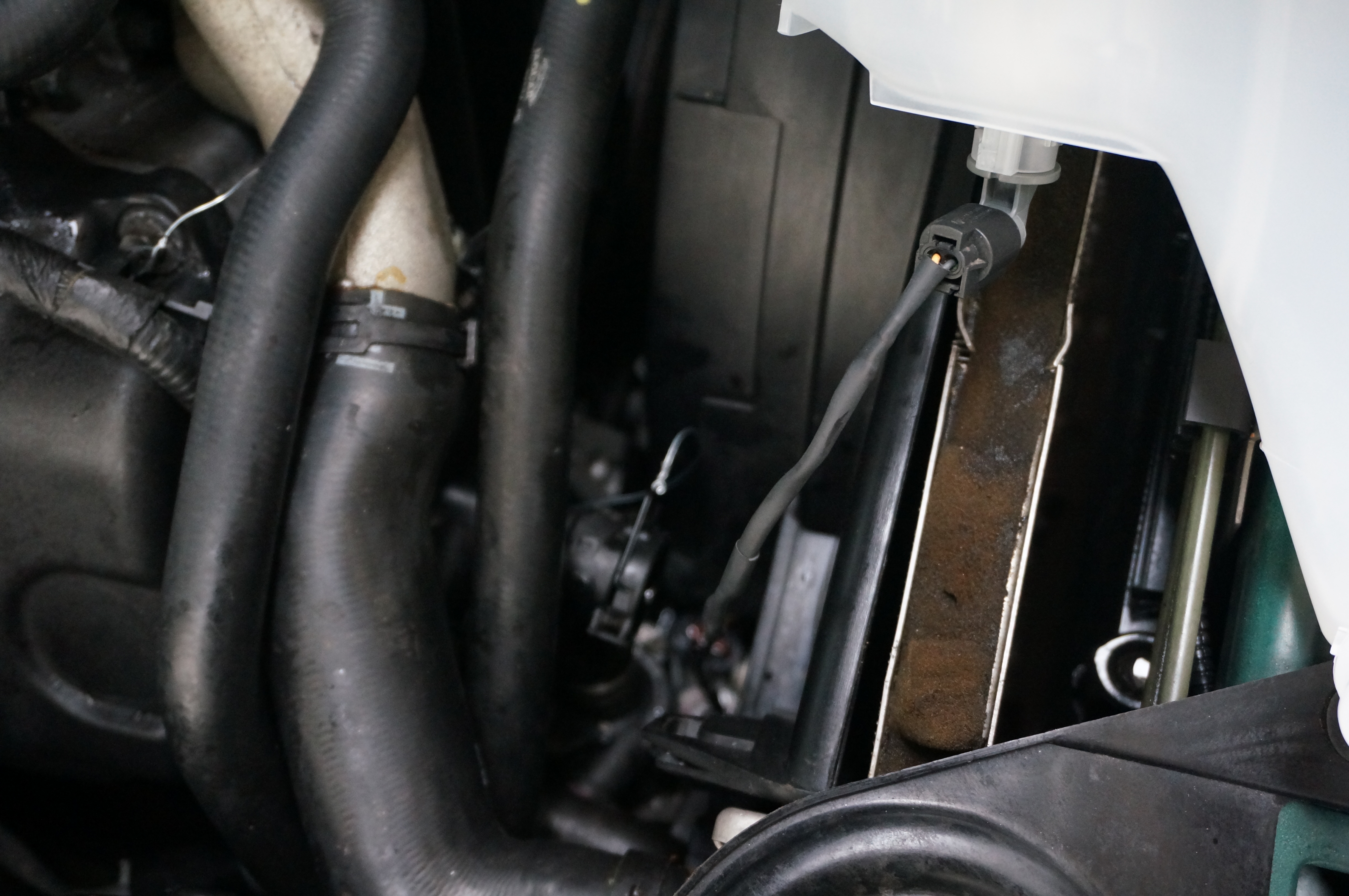

So here are two modifications I made.
1. safety wire for the clip. Obviously I need it ...
2. I extended the harness for the low coolant sensor to make it a LOT easier to work on this tank.

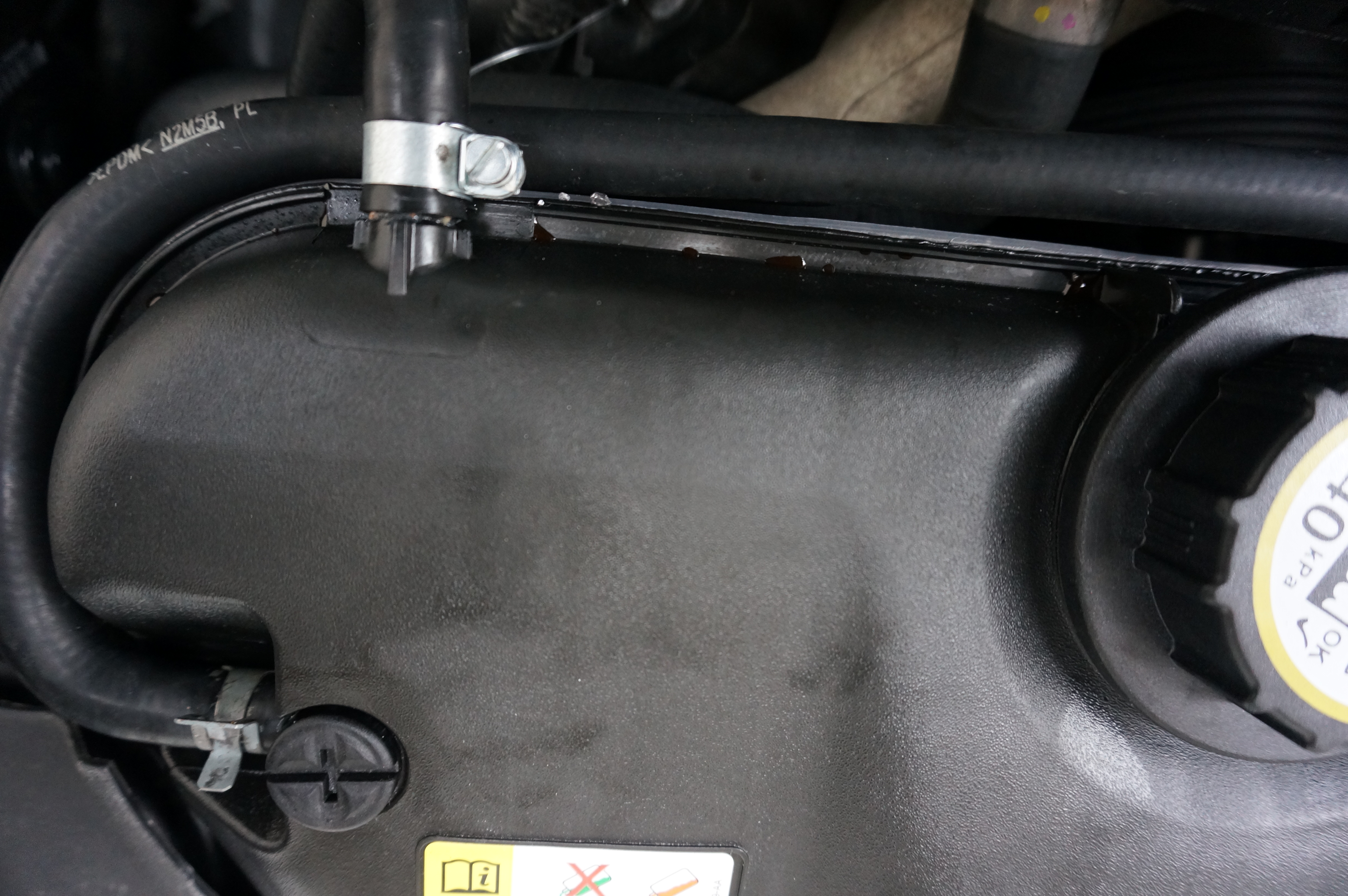

Three days later and now I have this
I've never had a car with such issues on a cooling tank.
Too mad to look at it right now. But I'm thinking an aluminum hand made tank is the only way out.
Attached Thumbnails Expansion tank and sensor issues - bad kitty once again-dsc00993.jpg   Expansion tank and sensor issues - bad kitty once again-dsc00994.jpg   Expansion tank and sensor issues - bad kitty once again-dsc00995.jpg

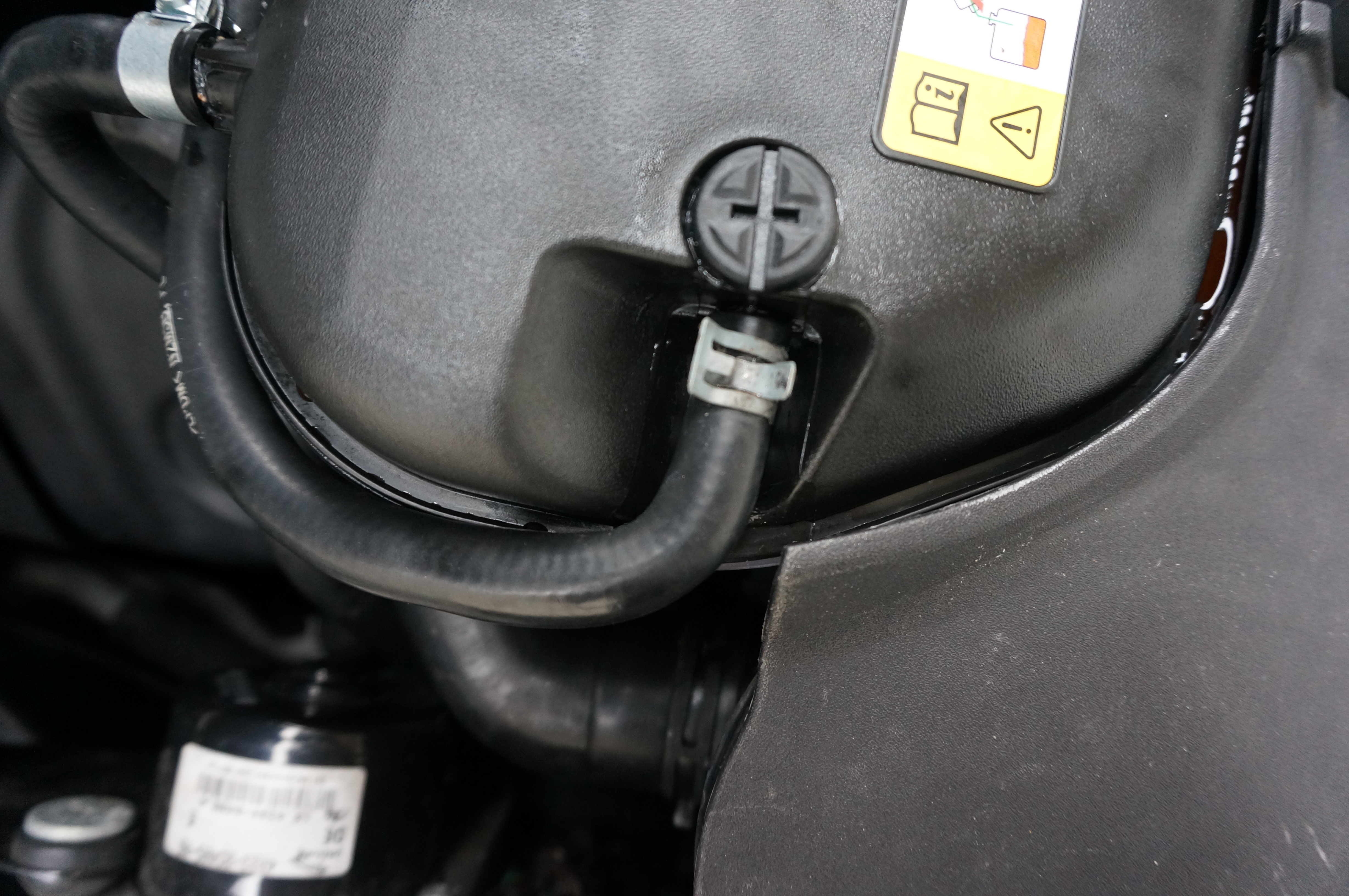

Old Jan 4, 2016 | 08:50 AM
  #38
Staatsof's Avatar
Joined: Jun 2010
Posts: 3,135
Likes: 227
From: No. NJ
So I installed a new section of hose 3/8" id using Norma #16 clamps on the new hose and a spring clip type clamp on the original hose with a barbed brass union.
I prefer the type that have a rounded bulb on the ends or softer ribs instead of these sharp barbed style as this original hose is quite fragile stuff. It means that you can't remove the hose from this fitting WO cutting off the joined section as it will be torn inside.
No leaks and the coolant level seems to be still settling after 2 checks with a couple of longer trips in the car.
Of course because I had a spill of coolant and was not able to flush it off the other engine compartment components like the radiator I continue to still "smell coolant".
At least I hope that's what's going on.
There's always that looming under the supercharger hose ...
Attached Thumbnails Expansion tank and sensor issues - bad kitty once again-dsc00996.jpg
