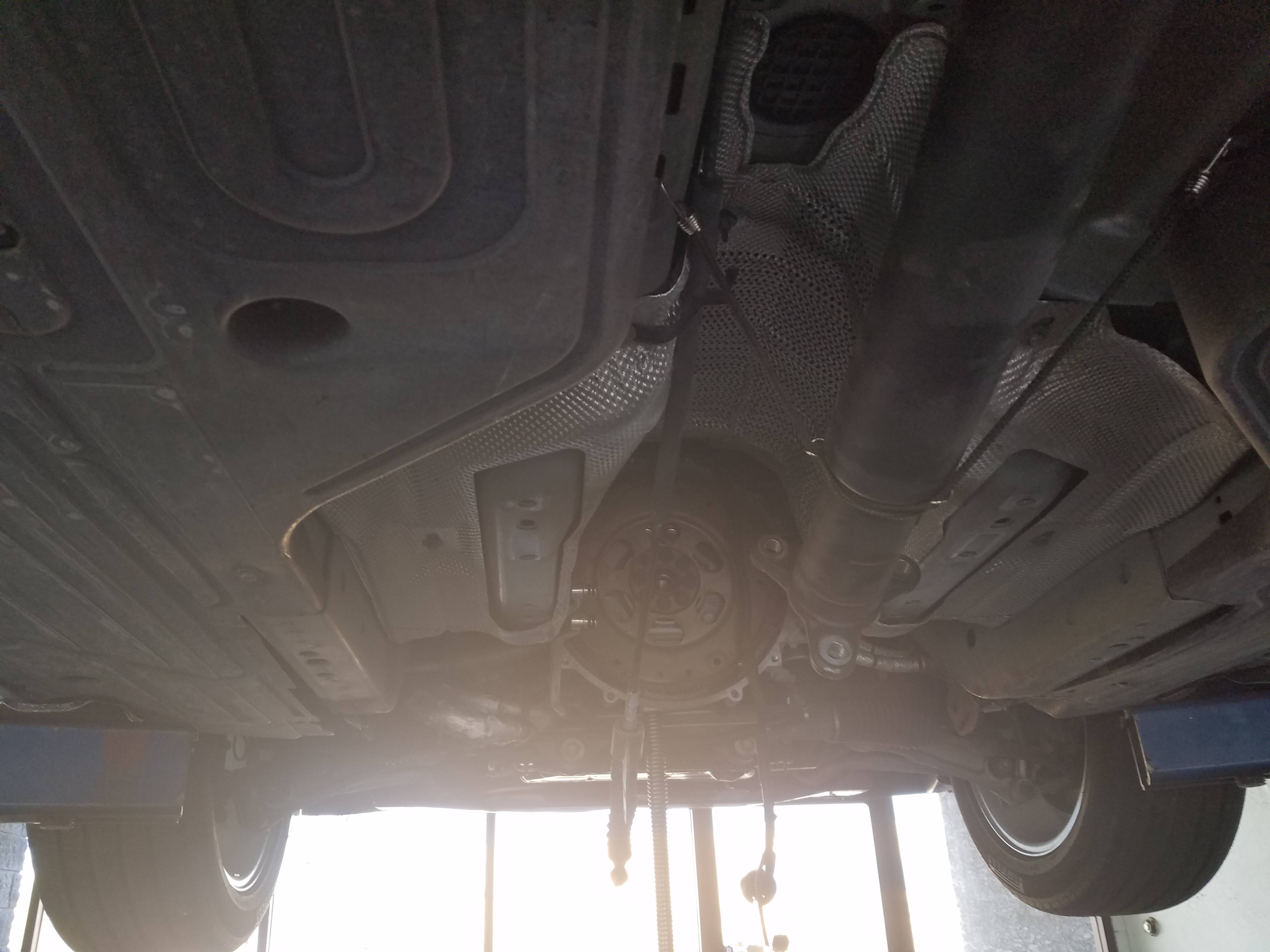

They didn't treat us as if we were crazy wanting them to pull the transmission ship it across the west coast wait several weeks for its return put it back in the car Update and test it. But they saved us thousands on our total bill. ( more on costs later ).
Also from calling me on the test drives to duplicate the problem, To the 1st class customer service in getting a pallet and securing it for pick up, When tranny was returned ( I liked the clean up and spray coat Transmission Express puts on after rebuild makes it easy to see leaks and Looks good ).
They had the car already up in the air waiting for delivery,,,
After going through all this effort, I love the car, and now I feel after driving it, I believe it will last for many more years. The costs the Dealership gave me,, a 10K quote for a New tranny installed, they don't work on them I was Told, ( I'll probably never be back there again). As well as the 3 local shops who quoted me between 4.5K to 6K or 5.5 to 7K, stating they would have to spend several hours looking over it after pulling it, before they could give me a firm price, the best warranty one would give, was 18 months the other 2 were 12months.
