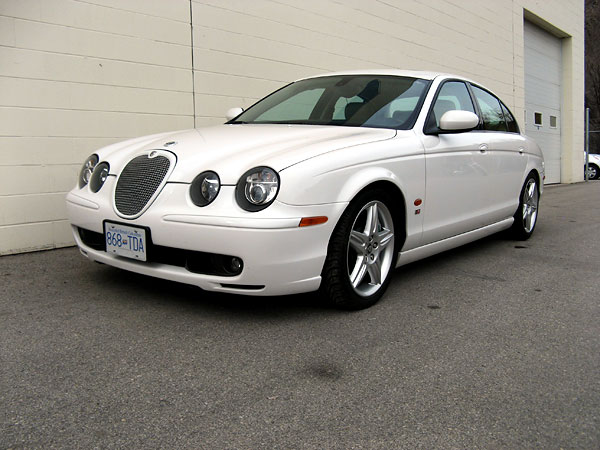

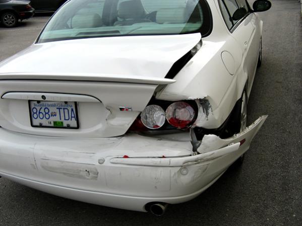

Here is the good side and bad side of the bitch...

It was rear damage that probably did not do any type of electrical or mechanical damage. Also, a good shop should have no problem matching your white paint... But I know it still hurts a lot when it's something you watch over so carefully....

damn that picture is painful....how fast did the idiot get up to to hit it that hard from a stop?!

I hate to say it but that car's totaled. The entire rear unibody has been compromised. Look at the waves in the quarter above the wheel well.
That thing needs both rear quarters, trunk, tail lights, bumper skin, all the supporting understructure (trunk floor pan etc), plus all the damage to the rear suspension, possibly a driveshaft, exhaust etc.
Thank god the car took it well and you are ok, that's all that matters. The car was beautiful, but it can be replaced. You can't.
Insist on NOTHING but 100% OEM parts sourced by the dealer. How many miles are on this car?

Both pics were taken at the same time. You will notice that the drivers side has absolutely no damage. The drivers side quarter panel is not impacted at all. All the damage is in the passenger side quarter. Their is no frame damage and/or exhaust damage. I tried to get them to write it off but they ain't goin' for it.
You can bet that only the best parts are going on the car as the owner of the body shop is my neighbor and they only deal in high-end cars. The car has 34K miles on the odometer.

Oh ok. I'd be curious to see the estimate... I didn't realize your car was that low mileage. See these cars being unibody don't have a "frame" in the traditional sense. The body structure makes up the frame. And I'm sure that rear quarter will have to go on a "frame machine" to be pulled out before it's reskinned. Does the rear passenger door open and close properly? That will give a good indication of how far things have twisted...
Have they pulled up the trunk carpet to see how the trunk floor looks?
You'd be surprised how much damage is revealed after things start coming apart. It's good to have the body guy on your side, especially if you have a good relationship with him.
