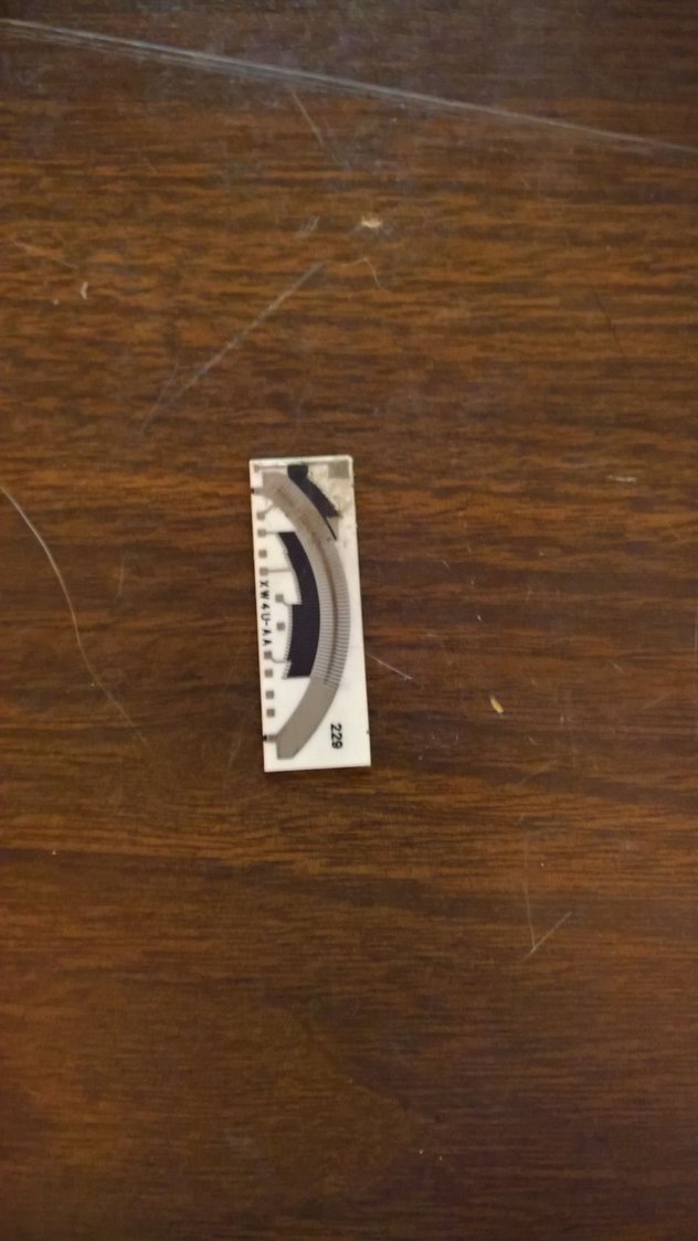

When I bought the car the fuel pump was bad, when I was replacing it, I think I pulled the wire off of the circuit board for the fuel pump sensor because now it won't register.
My question is, can I reattach it and if so, how? I've tried soldering it back on but the solder won't hold.

There are 2 fuel level senders. The INST PK calculates an AVERAGE between the two.
No idea which one that is, but if it was on the electric pump module (not the jet pump) then you are talking about the right hand side pump.
Might find a good used replacement in a salvage yard??

Yes, that fuel level sensor is from the RHS (passenger side in the US)

if it was soldered in the first place it should solder again , might have a wax coating ?
You could drill a small hole and put a brass nut and bolt/or rivet through it . If it has a wire strand you could crimp to it .
or just buy a second Hand unit .
