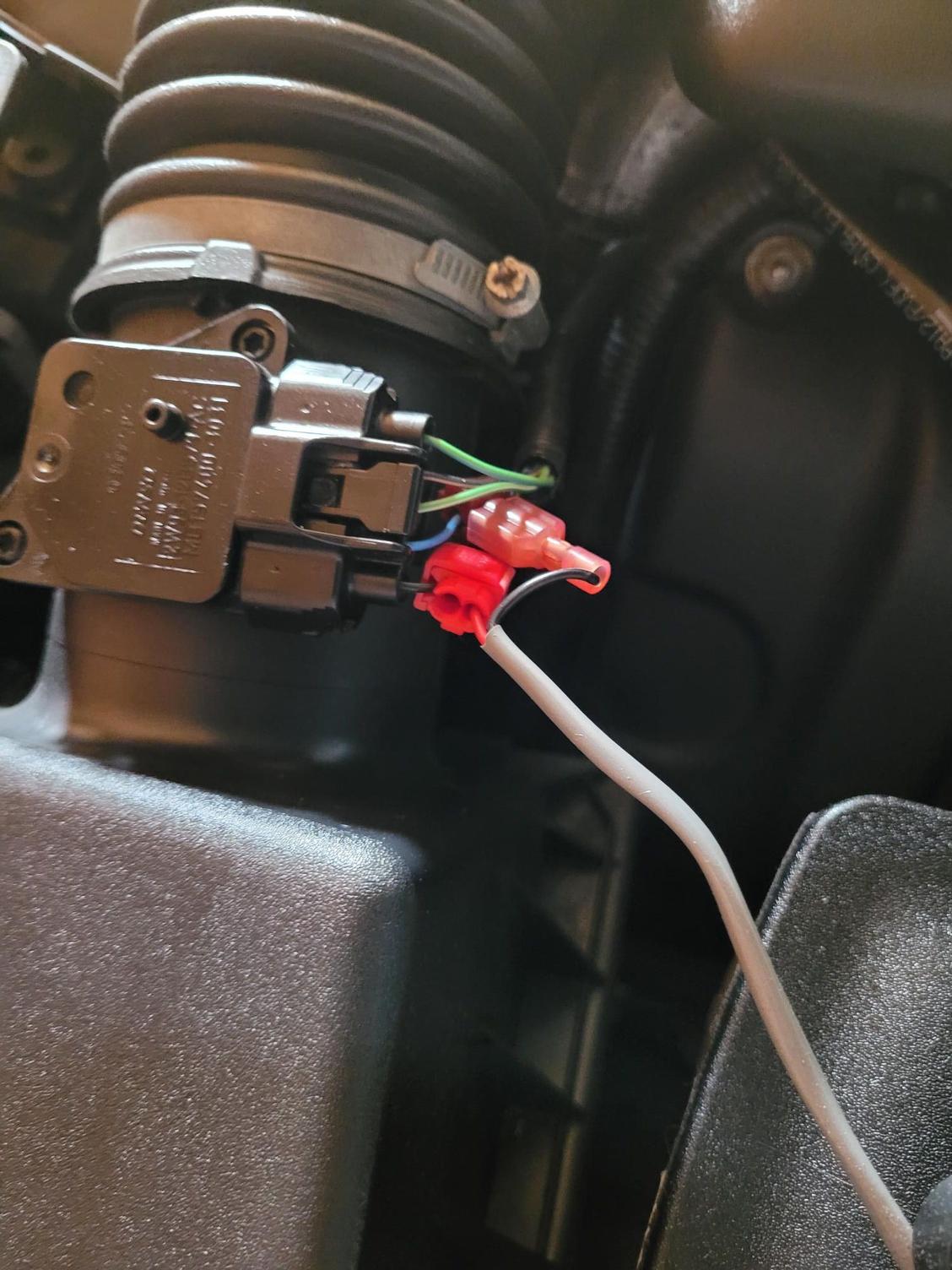

I've just taken delivery of my 2005 S Type R and it has a G Force Performance chip useless thing on it. Does anyone know to remove it do I just unplug these red connectors that go to it?
Thanks

Yea those were junk for sure!
Yes I would remove the two red crimp on connectors. Where does the wire go to? Remove all that too?

Thanks that's what I thought. Grey wire goes to the G Force box.

After disconnecting that poc g force just reconnect the original wire from the harness to the maf and you should be good
