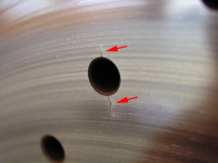

The holes, slots, dimples are not for cooling. What they do is allow gases to escape when braking. When braking, especially hard, the pads out gas and this gas layer can prevent good surface contact between the pads and the rotor. The holes, etc allow this gas to escape. The second reason is to continuously shear the brake pads to expose new uncontaminated pad material. This is why everybody gets added noise when using these types of rotors. All this is VERY important when running on the track and is of very little use on the street. So they are mainly for cosmetic purposes. Also be aware that you can get rotor cracking with drilled holes. So on the street slots and dimples are a better compromise.
As several people have noted the STR has pretty huge rotors from the factory and on the street I very much doubt any increase in braking performance is needed.
Here is a cracked drilled rotor picture.
Attached Thumbnails Getting new brakes for the STR-rotor-crack-drilled-hole.jpg
