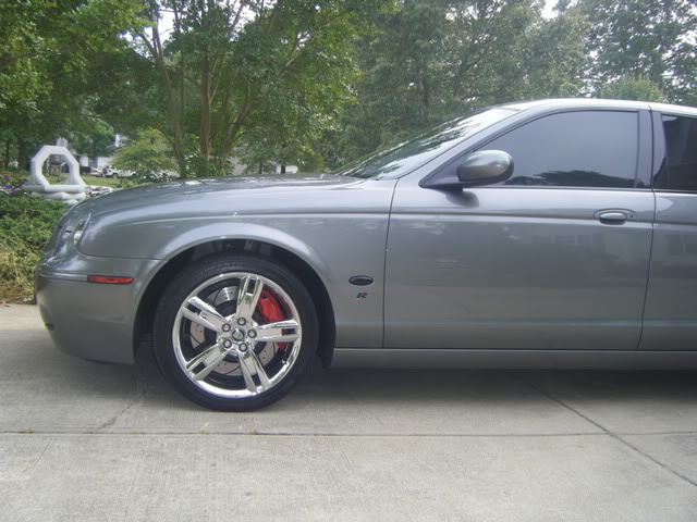

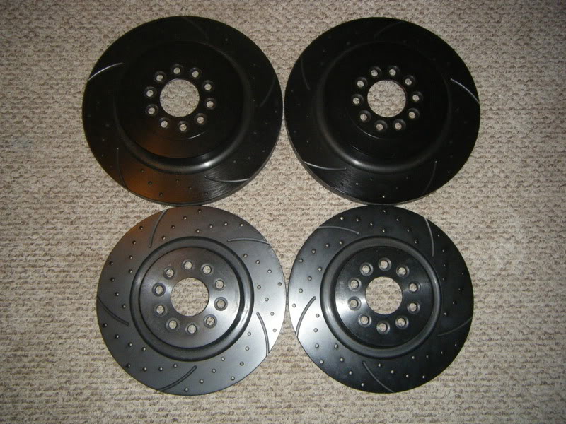

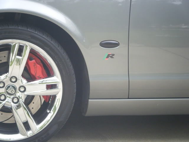

Just get the brakeperformance ones. Mix them with Akebonos and you will be happy.
Heres mine new and here they are on the car about 2 months ago. Still perfect no warps or cracks.

Vance, the look is incredible, but to get your setup is $700, I simply can't justify that much. I'm pretty sure they won't ever crack...Reason being, they're not drilled, we have huge rotors, B.P. mixes in other metal and guessing most of us are not racing.
Common reasons drilled rotors crack, drilled all the through, including the fins (usually the no-name brands), nearly pure cast iron which is extremely brittle (common on the no-name brands) and constant racing.
