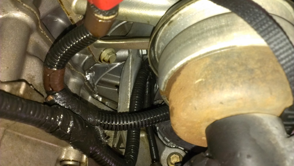

well, I finally crawled under the car today. I removed the belly-pans and found verification of my suspicions:
that must be a rod-bolt?
looks like the hole is punched just behind the alternator bracket, on the passenger-side.
Attached Thumbnails guess where i am......-imag0482_zps7f10f78f.jpg   guess where i am......-imag0483_zps09ac87f4.jpg   guess where i am......-imag0481_zpsfb083ff8.jpg

Jeeze- that's terrible news. Really sorry to hear this- I was hoping it was something simple.

Wow! She sure died sumtin fierce. Have you located a decent long block?
