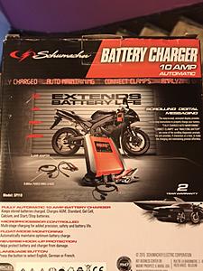

This is the battery charger am using;-

That looks like it should work. Does it give some sort of indication when the battery is fully charged?
If so, run the charger overnight, until the indication says the battery is fully charged. Disconnect the charger and make sure the prestart voltage remains above 12.6. Let us know what happens, so we can walk you through the next steps.

To check whether it's 12.6, it needs some load to dissipate the surface charge. (Headlights will do)
