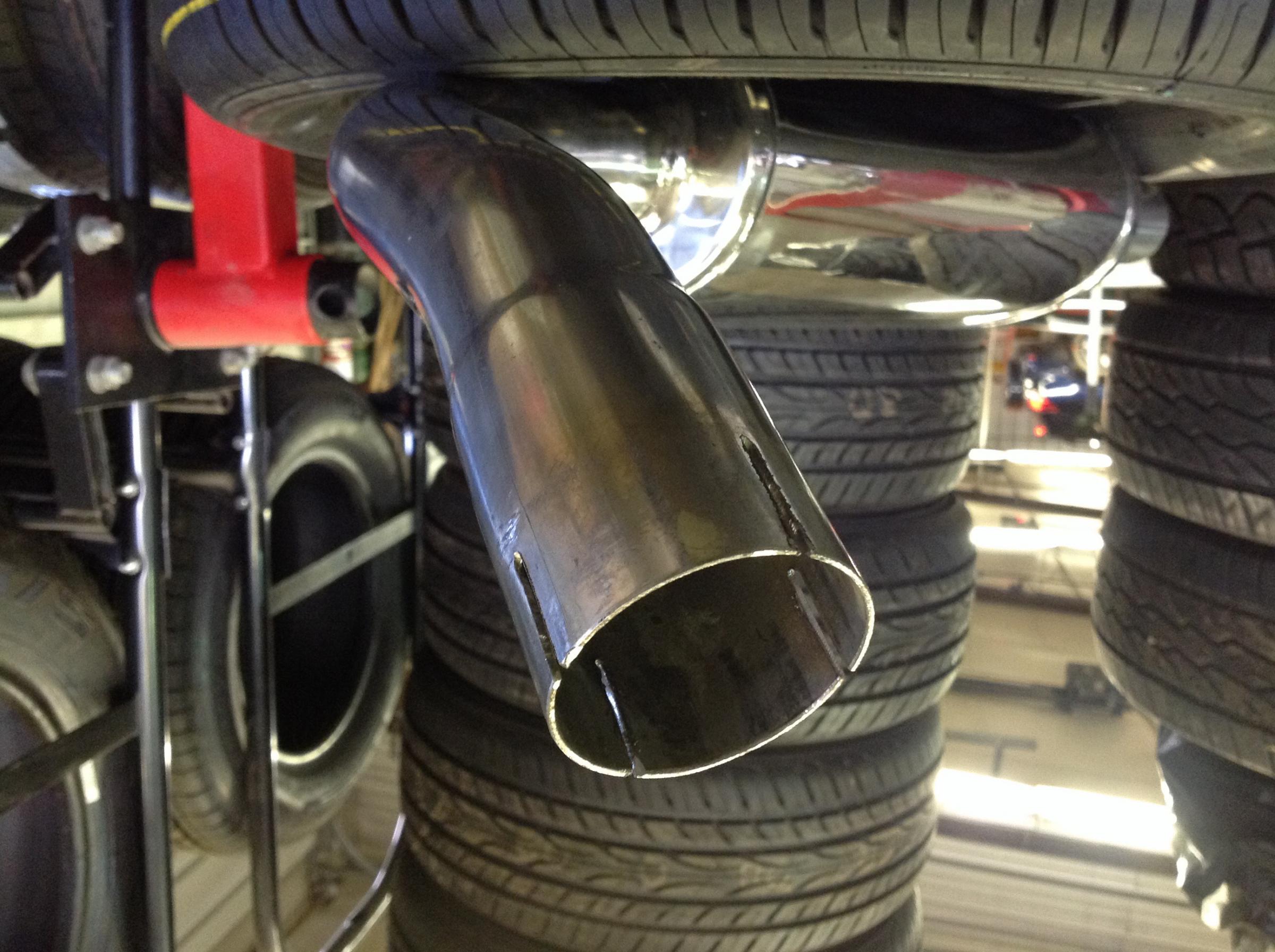

Oh, I also cut 2 more notches in each of the Mina exhaust pipes to better clamp down. I will post pics

Modified pipe, not sure why this is upside down
