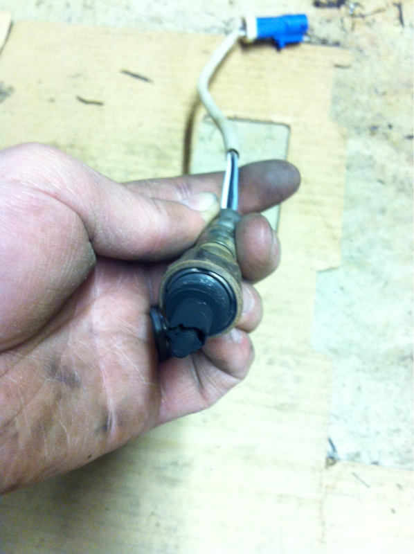

got it all back together, but same thing, so i did the running test with my 3100e obd2 tool and it pulled p1131, which i looked up and it looks like its an o2 sensor issue bank 1? so i took them all out and checked them, all were ok except for the drivers side furthest back. is that up or down stream? anyway the tip was broken off and it was really black. i took front one off and cleaned it to see if it will help. im probably going to pick one up locally. anything else this could be? the drivers side exhaust is clearly running way richer than the passenger side.

P1131 is bank 1 (RHS) upstream. Codes PDF & JTIS are free on this site, with the info.

i looked up the codes and it had some things to check. i just couldnt find which one they considered upstream or the correct side. bank 1 is pre cat right off exhaust on US passenger side?

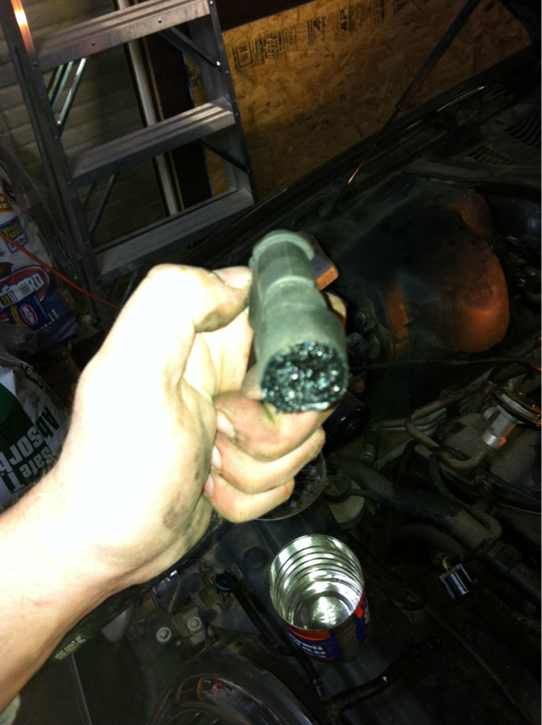

One is photo of the o2 sensor other is below the elbow that everyone has issues with it was that melted/plugged.

stream is about exhaust gas

I'm going to test then when I get home with ohm meter. Rockauto has the or direct fit for 24$ a piece I know I'll need at least one.

Both passenger side o2 sensors tested bad, ordered from rockauto also tested for vac leaks with a cigar and found none think issues are o2 related.
